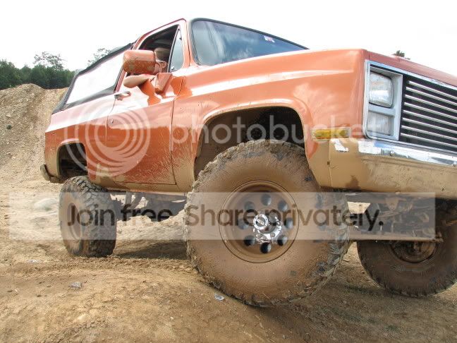

I wanted to lift it and get some new tires and wheels. I opted for a 4" Superlift and 35" Pro Comp MTs on Eagle 589s. I had some body work done to it, and they replaced the hood, straightened the body, removed the rust, fixed the hole in the roof, and were supposed to primer it. Turns out they only primered part of it.

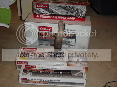

The machine shop messed up on the heads and due to time and money issues I drove it back to VA from TX on 7 cylinders. Turns out they set the valves wrong and 2 pushrods broke. I dont know how it made it the 1400+ miles to VA, but it did. I talked the wife into letting me get the whole Edelbrock Performer package for the TBI, which included heads, cam, intake, and of course headers.
Damn nosey ferret:

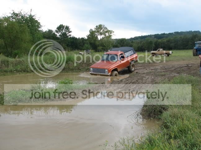

Had a lot of other work done from new u-joints everywhere to a new radiator and all kinds of other crap. Then a trip to the beach to see how well the 4x4 worked:
Then a trip to Harrisonburg to Big Boys Playground for a little more testing...

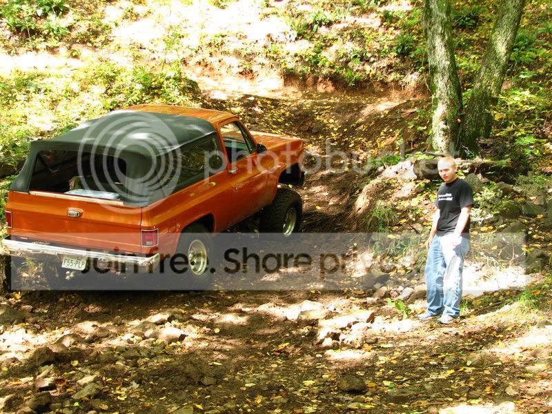

Next was a trip to GW National Forrest....
This trip kinda turned out to be fatal. After getting towed off the trail with nowhere to hook up to other than frame, I decided it was time for some new HD bumpers. Also I screwed the tranny up. I re-enlisted and had a little extra money so I bought some new toys...
