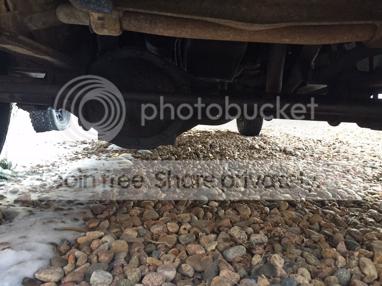

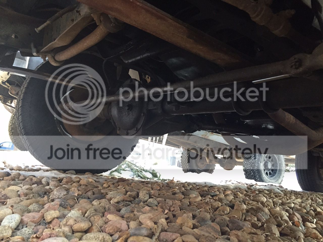

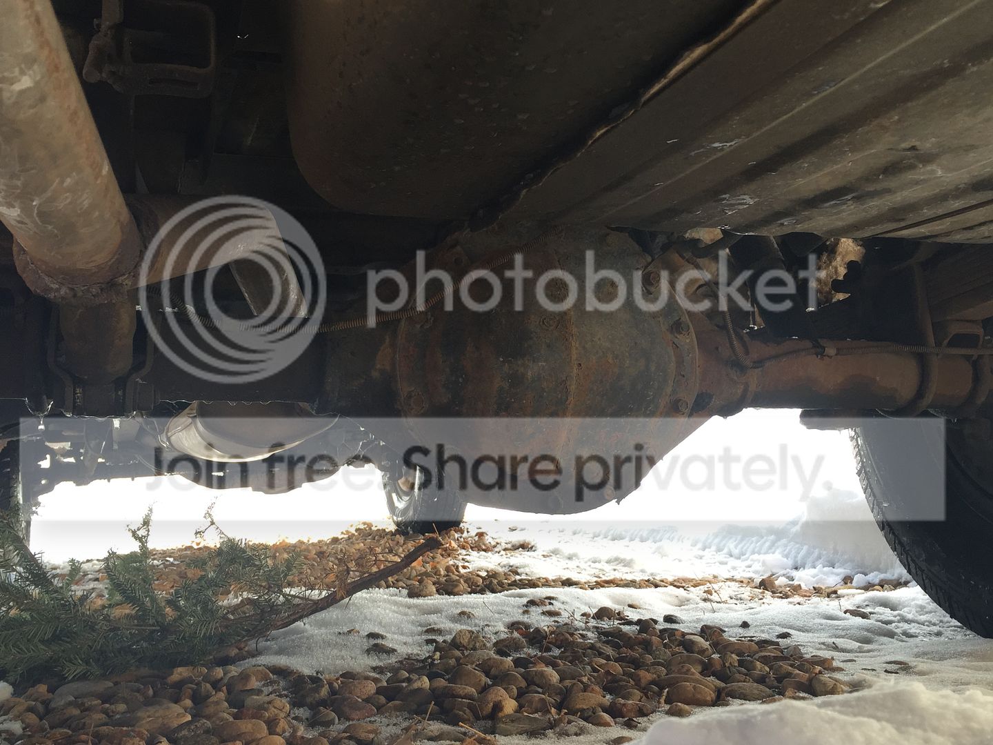

I think I done goofed... So, I bought a running/driving/braking Craigslist truck for $400.00 , in the snow, at night with only a phone flashlight. It's titled as a GMC 1981 Suburban 2500..?
Apparently I can't count to 14, nor was I dissuaded by the oval shape...So, now what?! Appears I have a GM 12 bolt. What should I transfer to my truck? Will this bolt in?
The front dif has manual 'superwinch' locking hubs. My truck has automatic.

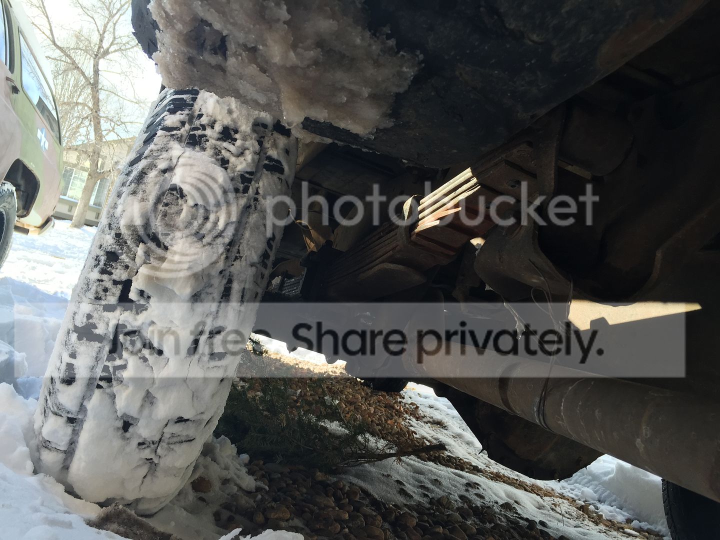

I think my truck has 4 or 5 leaf springs. This looks like it has 7 ? (It's cold and my snow clothes are in the wash or I would go verify)

and the leafs

Ok, first of all, check your counting again. I've counted the bolts 4 times now, and I can't get to 12, no matter how I try. That is a 14bsf axle, consistent with a 3/4-ton truck of that vintage. It does have 8-lugs, yes? You have the option of sourcing 6-lug shafts for it or just swapping both axles straight across. Either way, you are dealing with bolt-in parts. :saweet:
Second, the GQ1 axle code sheds little light on what ratio that truck originally had, though you could probably figure it out with a little digging. This thread (https://ck5.com/forums/threads/gq1-axle-std-ratio.133111/) is a help in that area. It's probably a 3.73 or 4.10 in a 3/4-ton of that year (pure guess on my part, you won't really know unless you pull the covers).
Third, the G80 code refers to having a "gov-loc" unit in the rear differential. Read up on these. The differential locks when the wheel speed differential exceeds 100RPM (from side to side) AND the total wheel speed is under 25MPH. It's not like a clutch-based posi-traction unit, but it's not locked all the time like a Detroit, either. It has a unique place in the spectrum of locker options. Some folks hate them, some folks love them, most folks don't care. Everyone hates the 1/2-ton 10-bolt G80 units, as the carriers tend to fragment. The 14bsf and 14bff G80 units seem to hold up well enough.
Fourth, the automatic hubs in the front of your truck automatically lock when you engage 4WD AND DRIVE FORWARDS FOR A FEW FEET. They then unlock when you drive backwards for a few feet. The manual hubs in the donor truck do exactly what you tell them to do. Choosing between the two is a personal preference, but many of the folks here have had bad experiences where automatic hubs failed to lock when needed. And if you're already stuck, you can't spin the wheels forward to engage the front hubs without digging the rear end even deeper. The plus side is that you don't have to get out and manually turn the locks every time you wanna lock or unlock.
Fifth, the truck has extra spring leafs because it is a 3/4-ton set up for hauling heavier loads. This spring pack will be stiffer than your stock 1/2-ton pack, so you don't have much to gain by swapping it in (unless you are routinely bottoming out the 1/2-ton pack). If you wanna use it I would remove a few leaves to bring it in line with your existing spring rate. Or, since you aren't complaining about spring problems, I would just leave it alone.
You'll have to work pretty hard to break the 14bsf with 33" tires. I think it will serve you well. You don't have to do anything to it (assuming it has no issues), but rebuilding will bring some peace of mind that it will last a while. Or you can wait until it breaks and rebuild it then. The feeling of having much more torque probably means that you have lower gearing in the donor truck. Which may be a bonus if that's what you want in your application. If so, no regear will be required. :thumb:

Ok, first of all, check your counting again. I've counted the bolts 4 times now, and I can't get to 12, no matter how I try. That is a 14bsf axle, consistent with a 3/4-ton truck of that vintage. It does have 8-lugs, yes? You have the option of sourcing 6-lug shafts for it or just swapping both axles straight across. Either way, you are dealing with bolt-in parts...Post up some more detailed specs for each of the rigs, and we will continue dispensing free advice. :popcorn:
Sure enough, with the snow melted it does have 14 bolts. I am glad I counted right when I bought it haha! Now I feel a little silly, but am glad to have been wrong!

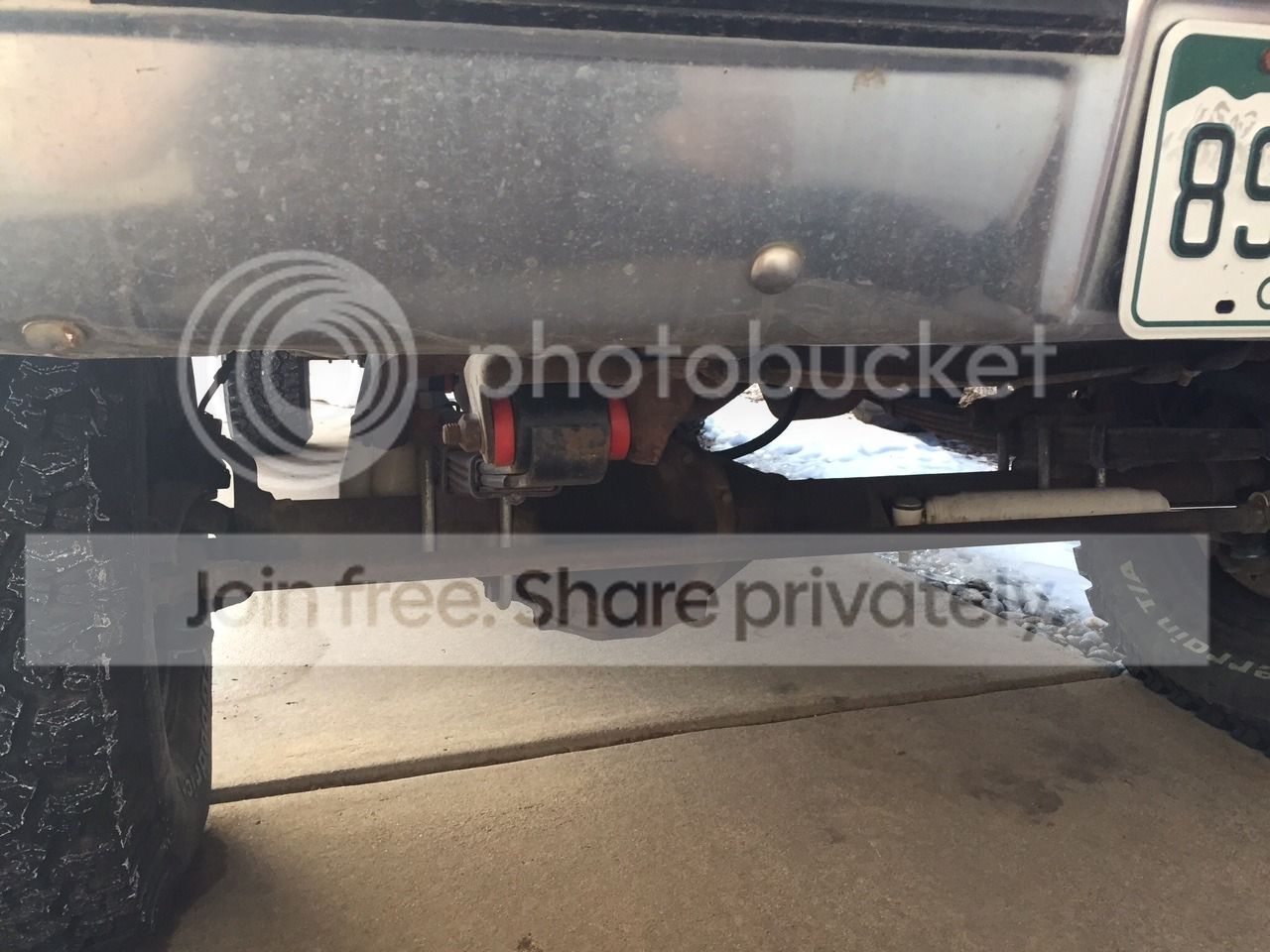

  • The brackets that hold the bumper on appear to be cut to fit the bumper (I don't want to cut my bumper brackets up to fit the bumper, since it doesn't have a winch mount. I do want to learn welding and if my job interview Monday goes well, Ill have a welder in 2 weeks time.
