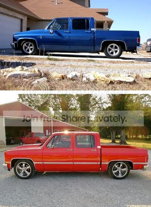

So..... debating between cutting and sectioning the frame to shorten the wheelbase down to short shortbed length OR moving the spring hangers forward and chopping the excess frame off the back end. (if just moving the hangers forward, will this work at stock height? May be a while before I can afford a lift) Either way, about a 140.5" wheelbase, 2' shorter than stock, and about 9" chopped from the rear overhang, for about a 5'3" or so overall length to the bed.
Thinking I may go ahead and do a dovetailed tube bed skinned with cut down bedsides, and may taper the front clip too!
Thinking the side profile will be something along the lines of these (but with a little less rear overhang, equivalent to that of a Blazer):
http://i45.photobucket.com/albums/f87/Ipodjunky/Barrys4doorlowleftview-1.jpg
(photoshops from 67-72chevytrucks forum)
