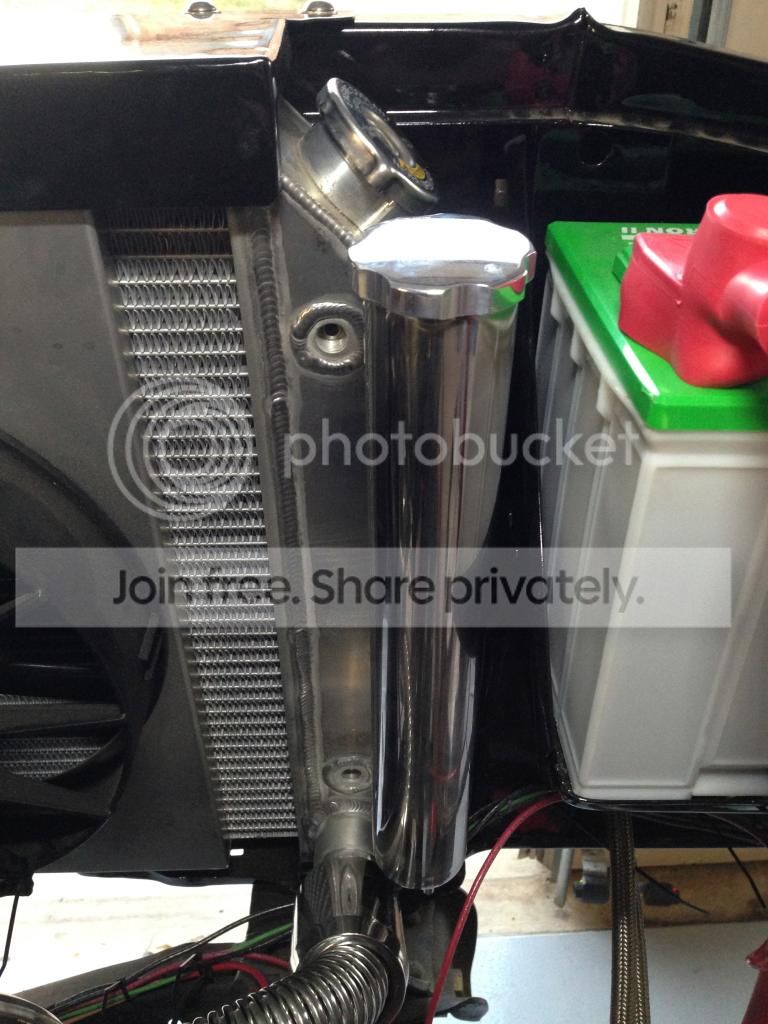

Older pic....I had a couple of tabs tig'd to the side of my radiator. https://www.summitracing.com/parts/sum-299993/overview/
I have the same one on my Camaro and T-bucket. Looks good but doesn't hold much as I'd like.
