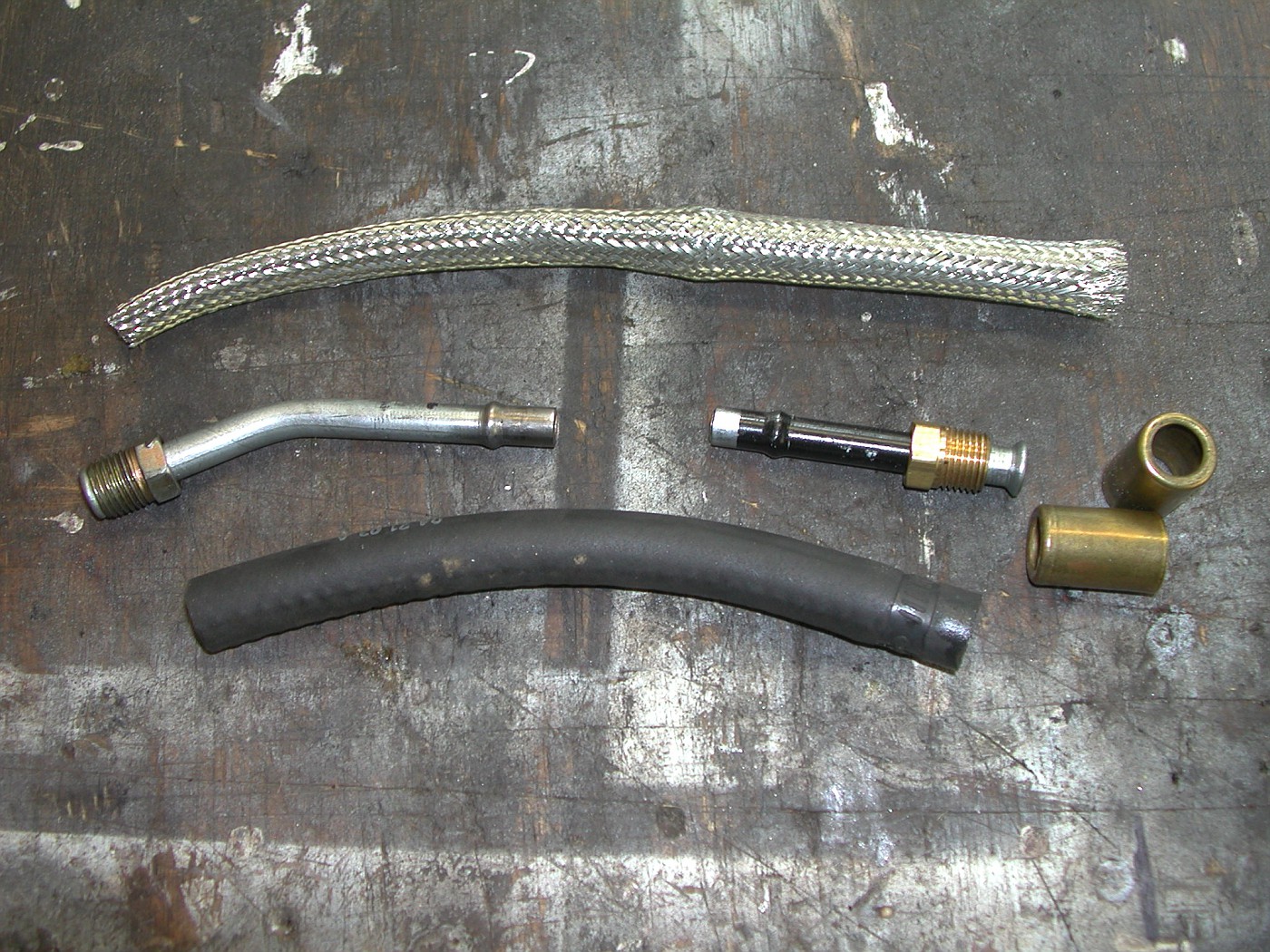

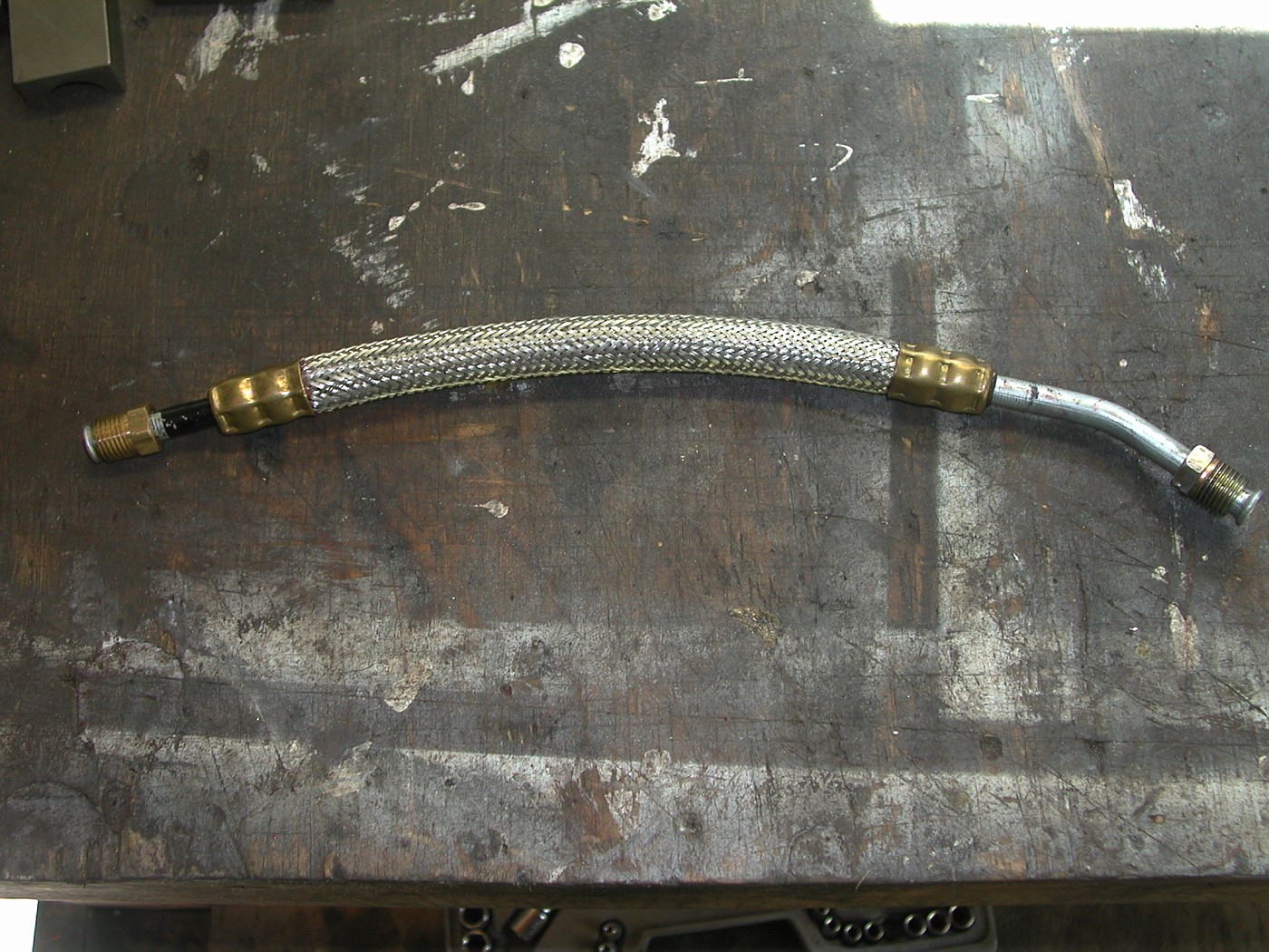

Make your own.
Here the post on how I did mine when I replumbed my cooler.
I made two of these.They go from the trans to the frame mounted hard lines.
Here are ALL the pic's.
http://public.fotki.com/blazbk/blazer_mods/transmission_cooler/
And the post I made.
http://coloradok5.com/forums/showthread.php?t=116384&highlight=cooler+pic%27s
