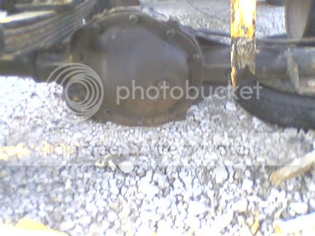

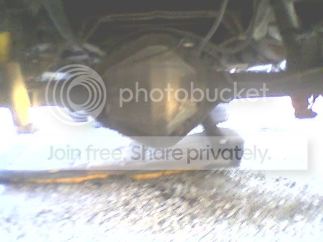

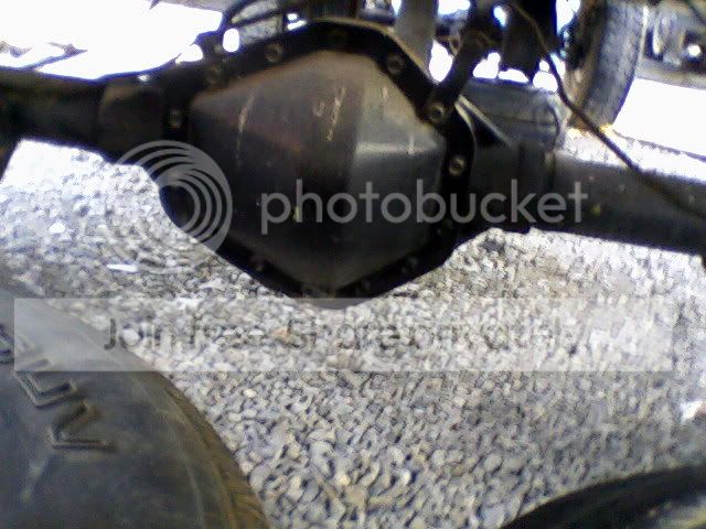

Could you identify these axles please.
blackk5350
Jan 15, 2008
929
kentucky
I had to take them on my phone. for some reason they wouldnt let me bring my camera in. im pretty sure the big uns are the 14 bolts. and the small one is either a dana 44, 60 or 10 bolt
if they are in deed a 4 bolt and at least a dana 44 im going to pick them up this week. the front axle was on a 77 camper special or something truck with a a little indian Tipee sign if that helps
ah hell i was hoping that front would have been a least a 44 so i could do a little beefing up on it. i will go pick up that 14 bolt this week. Het do you or anyone know how to tell the gear rati on on them
The easiest way is to rotate the pinion and count the rotations until you get one revolution at a wheel. The other way is to pull the cover and get the numbers off the ring, or count teeth on both the pinion and ring then divide the ring by the pinion numbers.
There is nothing wrong with a 10b front, they are just as strong, arguably slightly stronger, than a D44. And parts for most D44's will interchange. I am currently in the process of prepping a 10b and 14bsf to put under my Blazer. They just happened to have the 4.10 ratio I wanted.
