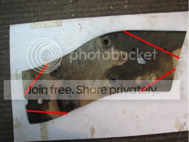

As for me I'v not had time to fix frame but I cut out a patch that I'm going to weld on from another frame and then I'll build my own brace. Went mud bogging recently so I wonder if the crack is any bigger? LOL.
Hers the patch, the red lines are where I'm going to fishmouth it. I was told to not angle them so seep as in the pic:

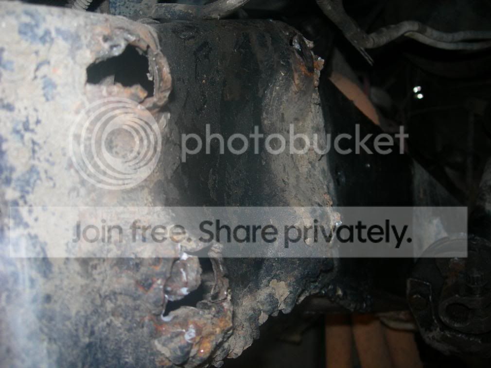

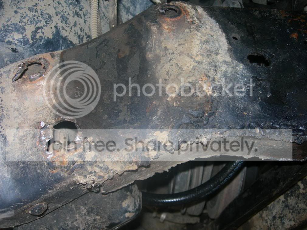

da frame
I got the truck, with someone already tried welding the gear box to fram what a nut.
I should waited on going rock wheeling and jsut should kept to the mud.
What i did was used strap ties around the gear box to hold it in place, it worked great and backed all the way up.
here is what the frame looks like horrible, im gonna have to have a pro handle this job.http://i187.photobucket.com/albums/x217/dbzgt545/my%
20trucks/frame012.jpg
Man oh man does that ever look nasty!! Keep me posted with pics as you get it fixed. I'll do the same. I hope to get at my truck soon (maybe this week, lol)
