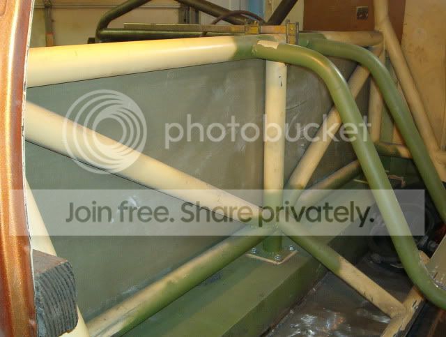

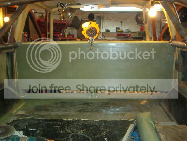

basically what I'm doing is building an 8" deep box on this divider wall thats bolted to my cage...

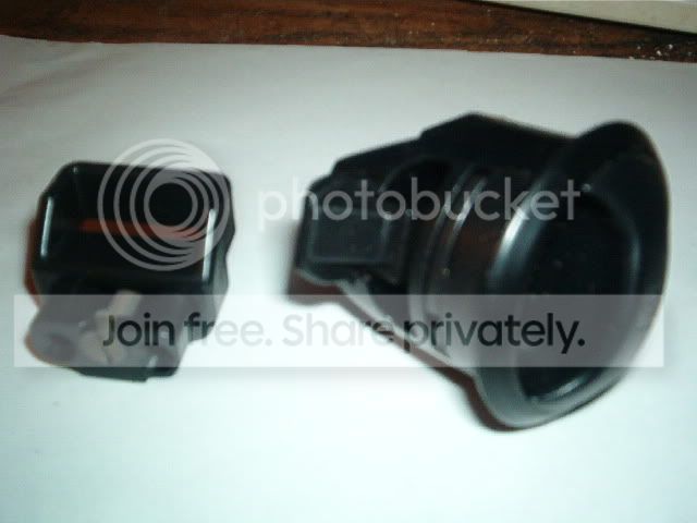

it will have 2 swing open doors in the bed.. using the same quarter turn latches as my console, glovebox, etc....
inside it will have a series of somewhat smaller cubby holes along the top for smaller parts, hardware, shackles, etc.. then below that it will have 2 full width larger compartments for pry bars, tires iron, straps, etc, etc.... all compartments will have a front wall varying in height depending on the compartment..
and obviously the whole thing is constructed using the same composite glass build techniques i've used thruout the build...
it will be straddled on either side by 2 sub boxes for some 10"s... i'll also be working that out over the next couple weeks...
