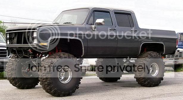

Yes you can put the crewcab body on the sub frame. You may want a BL but it really depends on where the frame rails rise at. I put a crew cab on my standard cab long bed truck. Now I have a crew cab short bed. I took almost 32" out of the front of the bed. And I used no body lift. I brought the frame through the floor then boxed around the frame with sheet metal. It may not be for everyone but i like it. http://pirate4x4.com/forum/showthread.php?t=598547
Just do a lot of measuring and try to get everything figured out before you make the first cut would be my only advice.

Well, I was sorta thinkin' from the bed! I guess I should have clarified that.
That's a nice rig. I believe someone here did the same thing a few years back and was trying to sell it in the for sale section. It was all done up very nicely, shortened bed and a fresh coat of orange paint.
Eric M.
That's nice. I was gonna junk my Suburban when the back rusts off (which is gonna take about 6 more months). Hell, I think I'll just hack off the back and make one of those. Of course, not as pretty, but it'll give me a year or more use until the cab rusts too.
Thanks GM for that quality sheetmetal during the 80s.
Eric M.
^^haha I was gonna say that just looked like a chopped burb to me, glad i wasnt crazy
