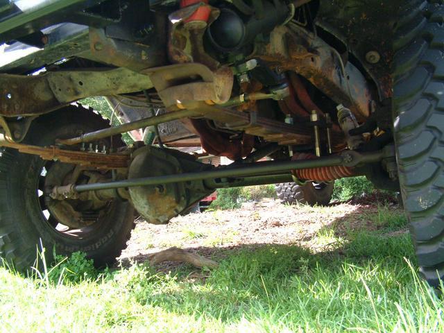

Seriously, it works fine. Even a straight draglink won't hit the crossmember on our trucks.... plenty of pics in my .sig
Greg is exactly right (as usual /forums/images/graemlins/thumb.gif). I have been scoping out the clearance I'll need to do crossover and there is PLENTY of room. Piece o' cake!! /forums/images/graemlins/thumb.gif
Here's mine. Only problem I see is that with a 4" lift the drop pitman arm is kinda close to the leaf spring. Gotta get the 42's and 8" leafs /forums/images/graemlins/laugh.gif
