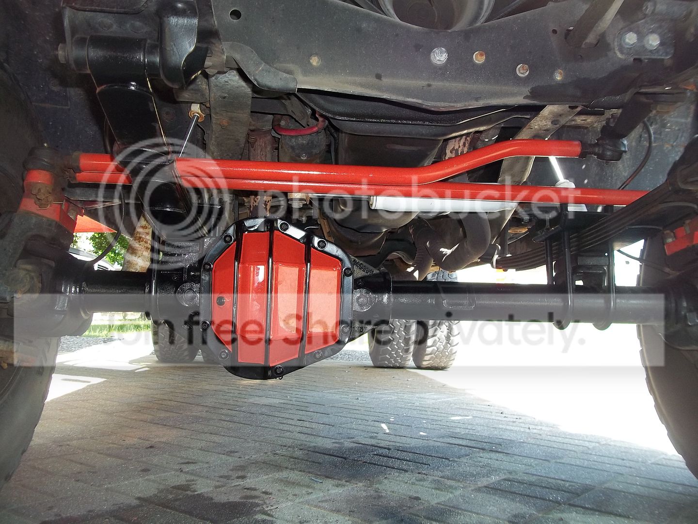

I also have a good bit of bumpsteer on my Suburban. 1 tons, 3" TC Ez rides, drop pitman arm, and bent draglink. Curious why some have none and others have quite a bit of bumpsteer? I'll take some pics of my setup post them here.
Those bent draglinks do nothing for you if you have bumpsteer.
If you have bumpsteer with a straight draglink, bending the draglink does not help. At all.
Not sure what you mean by this statement. Can you elaborate?
A bent drag link is only bent to provide clearance around some component, a bent or straight drag link are no different as far as the conversation about bump-steer is concerned.
