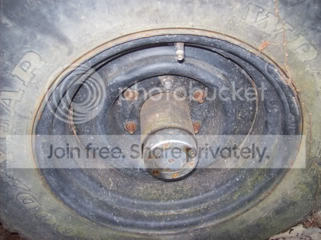

The word on Steel Soldiers is that they are a wider version of GM's cheapo 15x7 steel wheel of the time. CUCV specific.
That would actually be the "base" civilian wheel then, not a ralley. I *think* there were three widths of the 15" stock wheels, but 15x7 and x8 in ralleys, never looked up the base wheel width(s) available.
