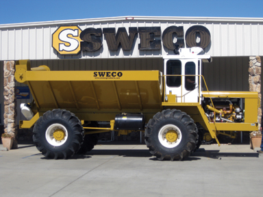

There are a few guys around here that use grain carts, but only when conditions are perfect and ground is nice and firm. They are also harder to maneuver as we get into a lot of tight spots. It's pretty tough to drag a 15 ton grain cart through mud like in the picture. Pretty much everyone uses self propelled 4 steer/4wd bankouts in northern California rice.
So pictured is a bankout that could be purchased, they are the only company that builds them to sell, and they are built to order.
Price: $140,000 :eek1:
I think I'll stick with building my own.

I see Sweco has the shorter wheelbase now, and figured it might be turning radius. I wasn't sure about turning radius though, I kinda figured it's a big field and you'd have plenty of room no matter what.

Do you have a rough idea of projected total cost? Just curious versus an off the shelf solution.
Well, that is a loaded question. Normally, it would cost someone about $50K to build one of these, if you payed market value for all your parts, built it yourself like I am, and figured your labor cost at a whopping $0.
For me, this project was actually started 2 years ago, and was started by gathering parts when things would come up for a real good deal.
Things I already had or were free:
Grain tank
frame
rims
tires
( all of which were already there from the old version of this rig.)
I got the cab, hood, and Allison for basically free, through trading of an old Pete that we junked.
I paid $900 for the 5.9 Cummins, again, I grabbed it because it was only $900......
The axles, I got an unbelievable deal on, the guy that owned the Military lift that they came out from had no idea what kind of money a monster truck guy would have paid. I paid just a little over what they would be worth for as scrap iron.
All in all, I think I am going to have somehere in the $17.5K range when done. Having a bunch of stuff already is a huge benefit, a set of four of the tires for it are $8K.
