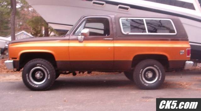

curb impact! what to check? (which is now about my steel rally restore)
No reason not to fix that. Some of the wheels we fix at work are just ridiculous. Thats the nice thing about aluminum, the cast takes a weld no problemo.
As far as the crash I would pull the u bolt and check the center pins didnt bend.
I took a good look at the tire. At first glance I thought it was shot, but after a better look, I think the distortion is just the tire bulging where there's no rim to hold it. I'm going to take some of the air pressure off of it and hopefully salvage it

I could have a friend help me weld it, but I don't know how to go about getting it straightened out and into 'round'. Would you do that with a lathe? That a job for a mechanic or a machinist?
Check around for a wheel repair shop, they specialize in this type of work.
Indeed. The welding can be done by any fabrication or welding shop that does TIG welding, but the reshaping/straightening of a wheel is a specialized business. Anybody that fixes wheels to that degree will also be able to TIG it up for you. I missed that it was bent. Its amazing what the specialized hydraulic tools can straighten out once you anneal a wheel.
I would say the tire got bruised badly enough to consider it NFG..
Be careful when you inflate it again,that bubble might pop !..radial sidewalls are pretty weak and dont like side impacts..or going over curbs at speed..

'deisel4me', you sure have my sympathy, that sounds like a bleedin nightmare! But cheap bastard that I am, I'm going to give it a go and see if the tire holds up, haha. If it's a days headache for the chance of staving off the purchase of 2 tires, I'll chance it.
As for the wheel, everybody's turning me away. I get the impression that most of these places are focused on cosmetic work and, while willing to weld a crack, none too eager to TIG in a chunk that came totally off, especially on the bead line. Whether it's not worth the work at that price point, or an issue of liability, or if I just can't be effectively done, I couldn't say, but no one's even entertaining it. I'm going to give it one more shot today - got a recommendation for someone that's been in the biz for a looong time, told if he won't fix it, it's a lost cause.

I think what burns me with the M/T's is not just that I like the look on this truck, but that now I have three that are useless until I can line up a replacement. Even if I tried to sell them, who wants three rims?
