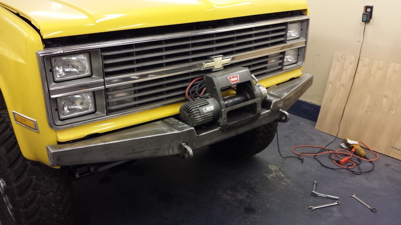

Any pics mounted to a truck?
does that have a body lift...![]()

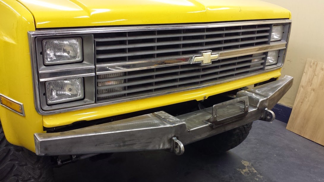

Didn't we have spots for 6 bolts?
You could do a little bit up on one side and a little bit down on the other side.

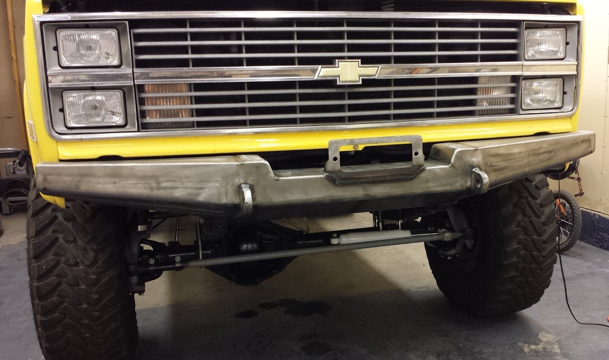

How about your core support bushings? Good shape, tightened evenly, etc.?
The bushings are all new and in good shape. Expecting everything to be correct to 1/4" is too much to ask I think, without custom tweaking. Plus, I probably didn't get the new holes perfect anyway.
Yeah, I guess there are 3 holes per side if you count the big oval one. I was toying with the idea of welding a piece of plate to go over the top, so the bumper would have an upside down "L" for mounting, but honestly, I'd have a hell of a time getting the mounting holes right without being able to drill through with it all put together. That area is all hidden once the bumper is on. If 2 or 3 is standard for all your bumpers, I'm sure it's good enough for me too.
My old junky rear bumper is mounted similarly, and if I jack on it, it rotates a little. That's why I'm thinking about it.
Did you send hardware? I didn't find anything. I'm just using grade 8's from my stash. Are the washers unusual in some way, or just flat washers?
I think I'm just going to rattle-can the bumper for now in black. If it doesn't hold up well, I'll consider powder later. It's not that hard to take off.
