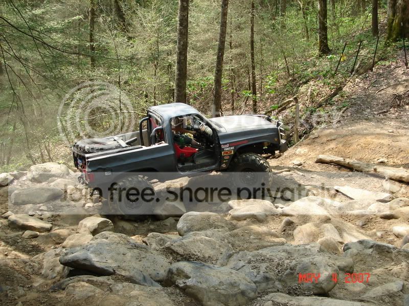

6" Skyjackers, lift shackle and trimming. springs are too stiff to stuff to firewall. they do rub the springs though.
