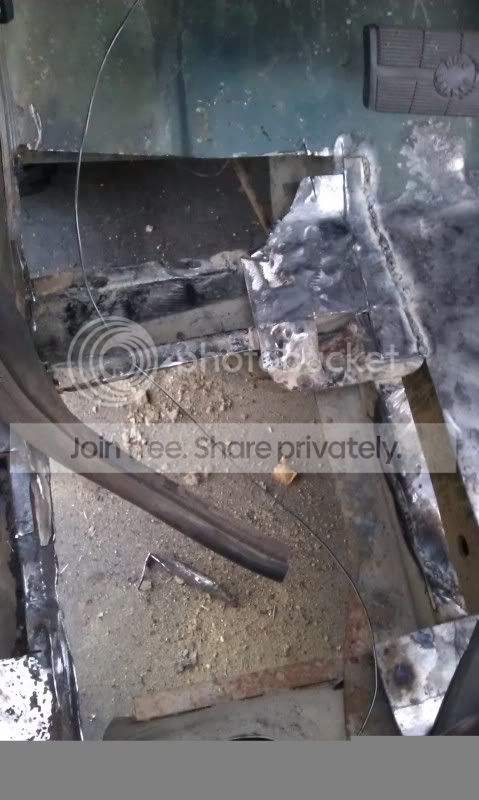

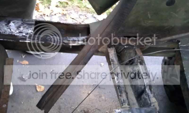

1-3 first day, 4-5 the next day. Ill try to upload them like this from now on.

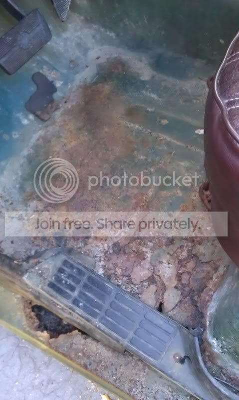

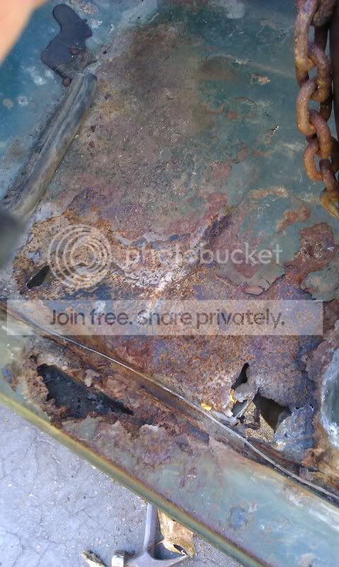

Pass side is fine, it wasnt even road salt. Rusted out from the inside out.. Its only bare paint and metal, no carpet so the paint got torn up and of course the metal rusted, never took care of it and bam, hole
The underside was still painted heh

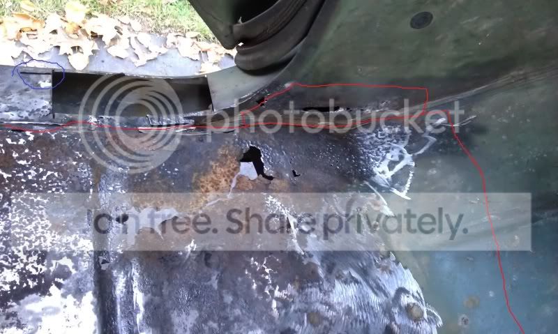

So.. I'm probably going to cut the floor and patch now, but the weld through primer doesnt come in until thursday/friday. So i won't be welding until saturday.. Think thats okay?

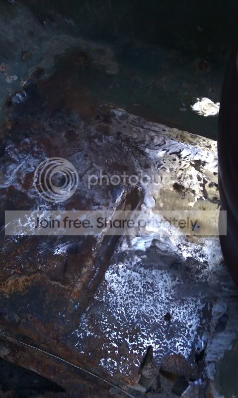

Edit: And those overcuts i made with the grinder, can i just fill those with slag and grind em even?

Dabba you'll want to weld the overcut part with a bead not slag depending on the width of your over cut. And yes then grind flat. What type of welder are you using?

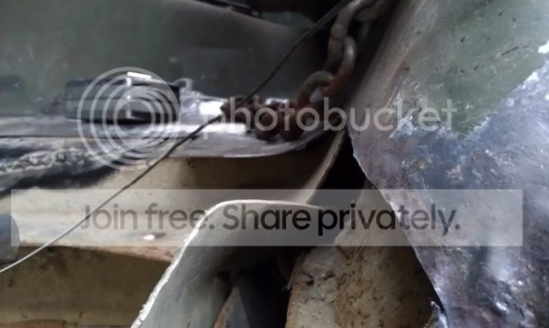

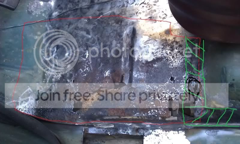

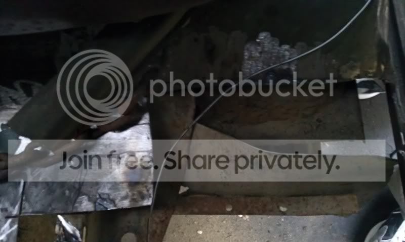

Started cutting today
I'm using a Mig welder, Today was just a bitch getting the floor out because some of it was tac welded onto supports so i had to cut at them. I cut into some of the supports which i re-welded so you might so those.. I basically ended the day taking measurements on my hole and figuing how im going to cut my peice...
This picture is showing the curve of the hump from the side. I'm going to have to fab/bend the metal myself somehow as i dont have preformed metal for it..

Are you using flux core wire. It looks like you got some slag. Not bad just more work. Most important thing is make the edges as clean as possible. When I weld seams I like to prep with a grinder flap wheel and it will help post weld to grind down and make flat. Use like a 80 grit and finish with a 120 or 150. Like 10 bucks each and get at a welding supply store.
Just remember push your weld not pull, keep the tip clean and stay consistent with your speed. Saves a lot of after work.
Thanks for the tip man, yeah i meant to leave a lot of slag, i had some space so i wanted to try more to fill it in. Was fixing from of my cuts. That peice in the center was under the floor and taced to it, as well as along the supports, what a bitch to pull up, hopefully the new floor fits right to it, hopefully afte Im done i could tac it back to the supports.
