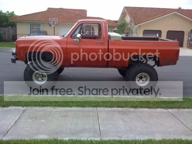

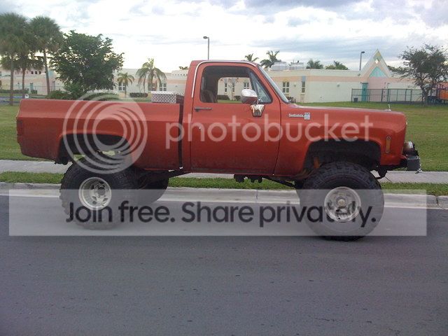

Here is how it sits right now. I know that if i get the blocks milled it will lower the front 1/2 inch which i can deal with later.

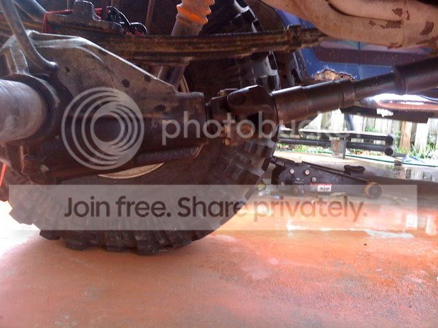

Here is my current pinion angle. The pictures is slightly off angle so it's a little missleading.

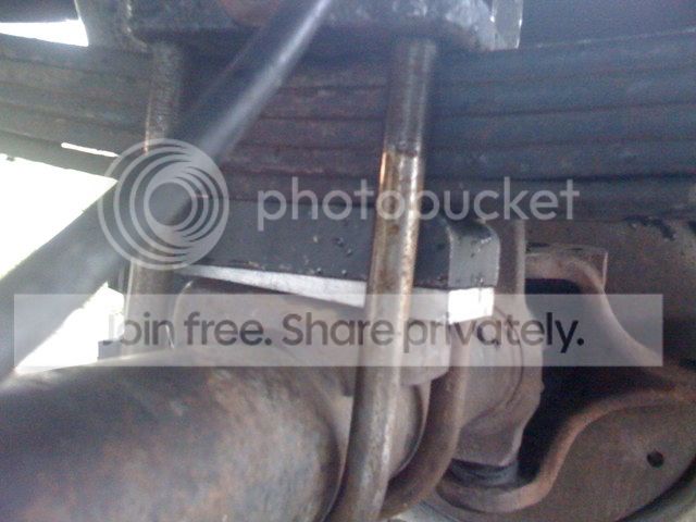

Here is my TEMPORARY aluminum 4* shim under the EZ Inch

Truck looks good, BTW.

looks to be that the pinion is pointed down too low to the ground.mine is at least 4 degrees pointed up more than that.with bigger tires you need some kind of stabilizer to help with wabble.i only run a single rancho and it is all i need because the rest of the components are tight and adjusted correctly.maybe he will chime in but thats what i did.

My guess would have been to remove the shim, although I dont know how much the zero rate was affecting angle. The shim in the picture is subtracting caster.
