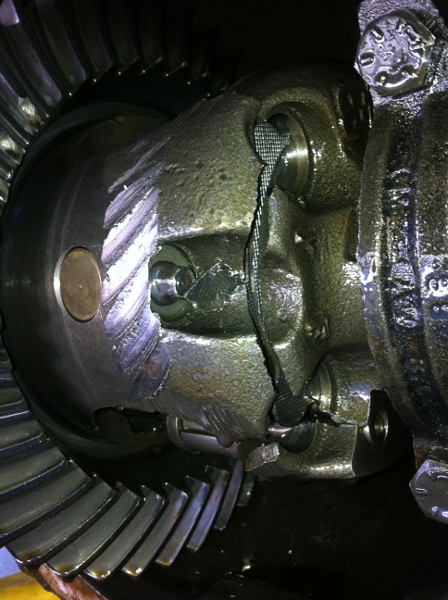

This is the second gov-lok that failed on me! Need something new that is better than a gov-lok but behaves the same!
I'll post pictures later. Looks like this time the case cracked and caused a grenade effect from that point on!
I hope that I can just swap out the ring an pinion set for a new one, an that the bearings for the axles didn't get damaged an ruin the race in the axle!

Auburn posi...much superior to the Gov-Lock with better manners and longevity.
Yeah, if you don't do any major off road or crawling a posi is perfect for your application. You could also look into the True Trac. It's a gear type posi with no clutches/cones to wear out. Absolutely silent operation and no special additives to the gear oil. I used one in a Camaro I built and loved it.
On the rear rebuild topic, plan on buying new carrier bearings. Sometimes they don't like to be removed from the old carrier. Same with the pinion bearing that gets pressed on to the pinion gear. So, just buy a bearing/install kit with the new gears...

It's not the ten bolt that is the problem, it is the gov-lok this time that cracked. It was a used unit that went in there last time when I got this axle. So the gov-lok is the weak point this time around.
