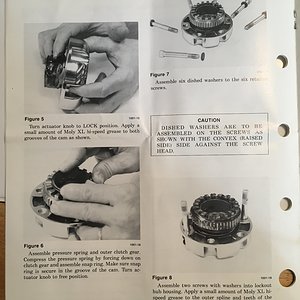

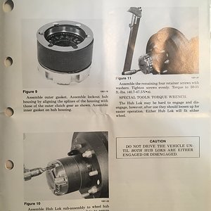

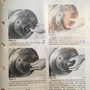

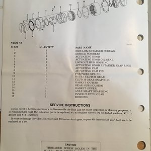

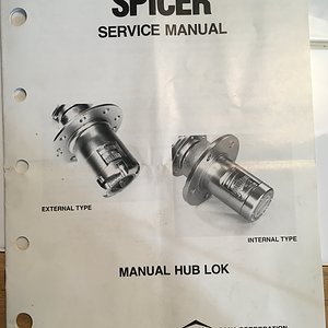

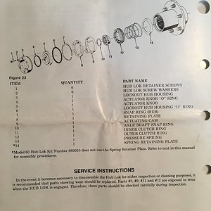

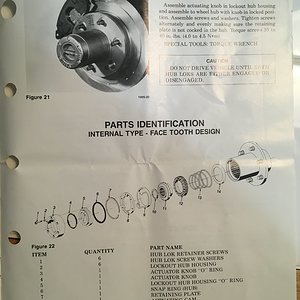

I may have a manual with the tq spec, I'll go check. I'd definitely use some blue Loctite as I recall it's common for those bolts to loosen up.
BRB
30-35 lbs ft per Spicer manual.
Be sure the bolts have washers, they use a specific thick washer with a small outer diameter to fit the bolt pocket.

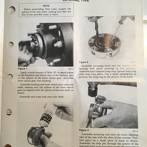

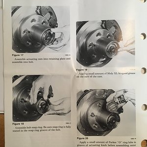

I'm uploading the manual to my albums now if you need any other info.
