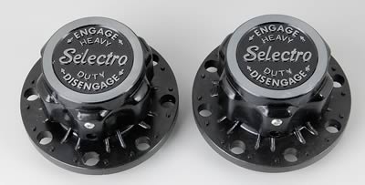

I think Milemarkers Selectro is the only locking hubs available for them.
