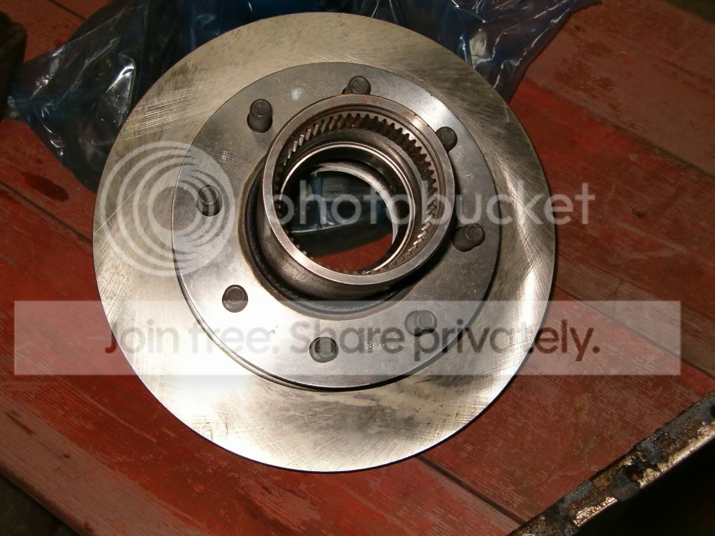

what parts are needed/different to go srw? I'm assuming the spindle...
Technically, only the actual bearing hub. Some people swap rotors too but it's not necessary, the DRW rotors have a smaller stud hole than SRW so they can be drilled out. The bit size is listed in the Dana 60 Bible on Pirate4x4.
Spindles, caliper brackets, etc are all the same.
The 60 Bible also details machining DRW bearing hubs to SRW to further save money.

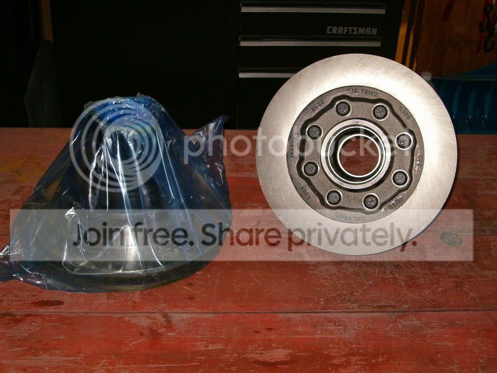

thanks... yeah, those are the ones I saw... and will probably do in the end... some of the eghey ones want like 350 for the same thing... :confused:
I got these about 5 years ago...
link: http://www.gmpartsdirect.com/results.cfm
part #: 15635530 129$ each plus 40$ each shipping/handling
