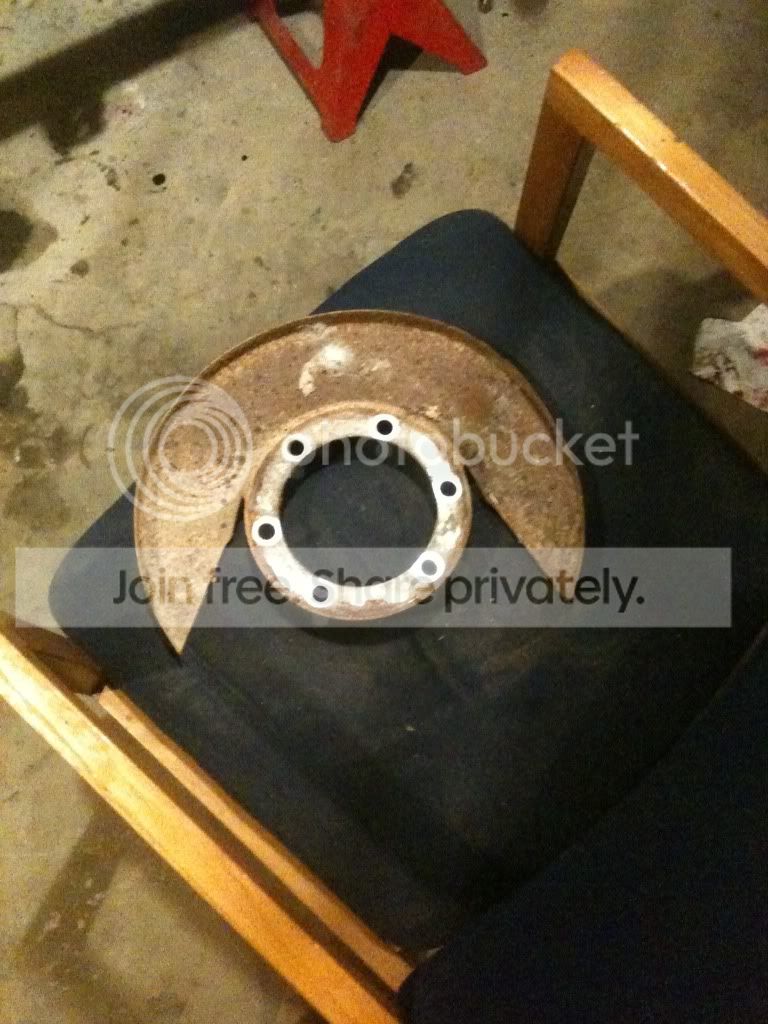

Do I need to install these?
If I don't have to, what are the pro's & con's of having them vs. not having them?
well, I had to remove them because rocks and mud would wedge in there and scrape the rotors making an awful screeching sound. You can simply remove them and be good. I really see no reason to put them back on but if you do install them at least cut the bottom of them so there is no mud trap anymore.

No needs, toss 'em
Sweet thanks guys. I was planning on tossing due to mud and chit, just figured I would check with the crew. Thanks again!

I had the flange left on mine, most of the dust shield was rusted away, or ripped off.

Necessary.. nope. I would only keep them if you have rims you want to keep nice and pretty, dust free.
Well I think they have them on there for road use. Hot rotors+ cold water splashing= warped rotors. Other than that I don't think they're needed.
