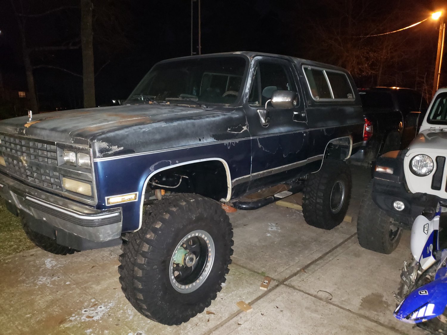

I ran 38s with only the rear brakes working on my tons and had zero issue stopping safely other than the rear locking up. Unless the 3/4 ton brakes are that much smaller than the 1 ton. Can't wait to see how it works with all 4 brakes haha.
i sure hope you didnt drive on the street like this . . . . if so you sir are not cool in my book .
