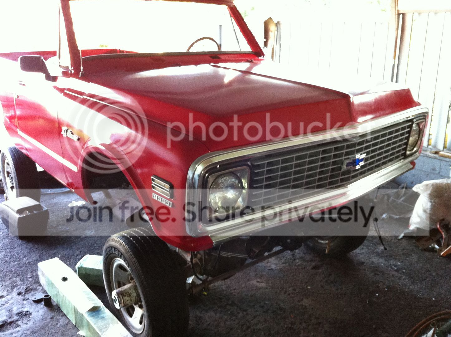

Here's a pic... I swear I'll take the real camera out there sometime and get some real pics...

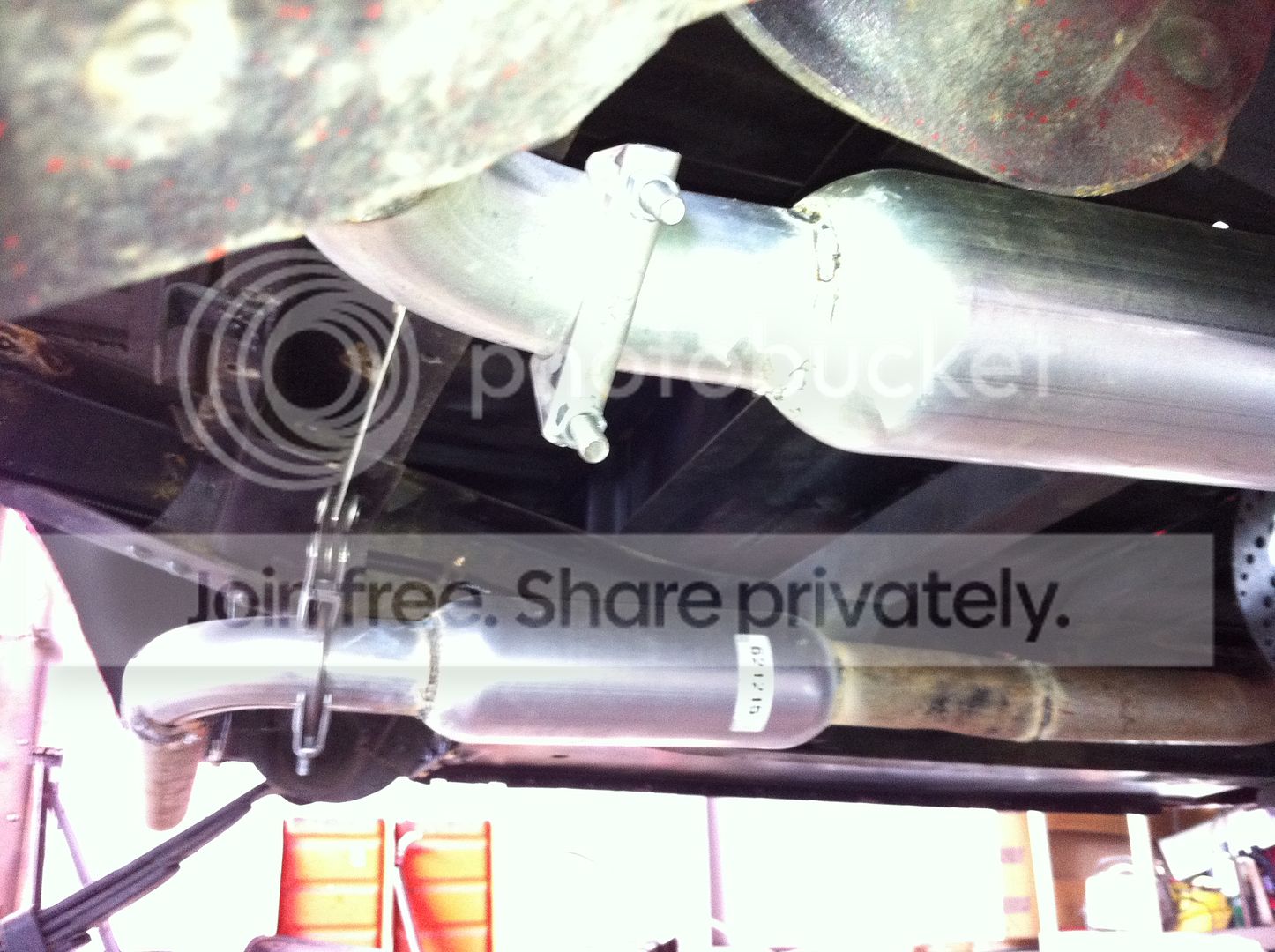

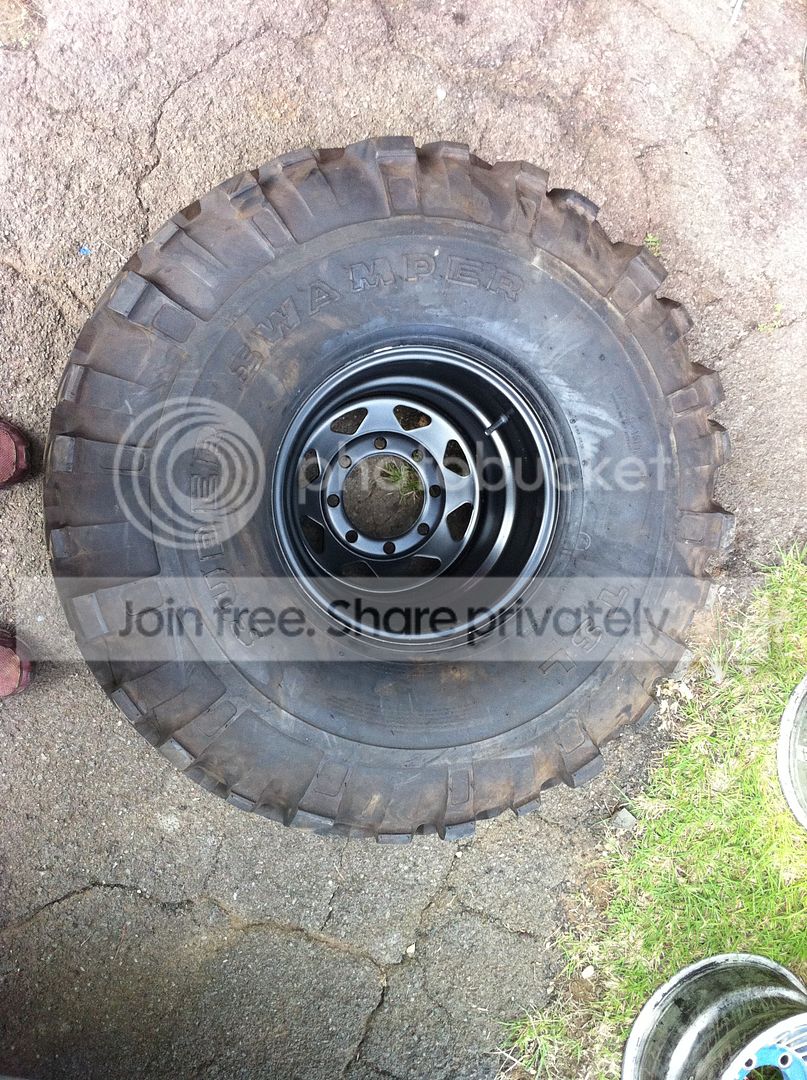

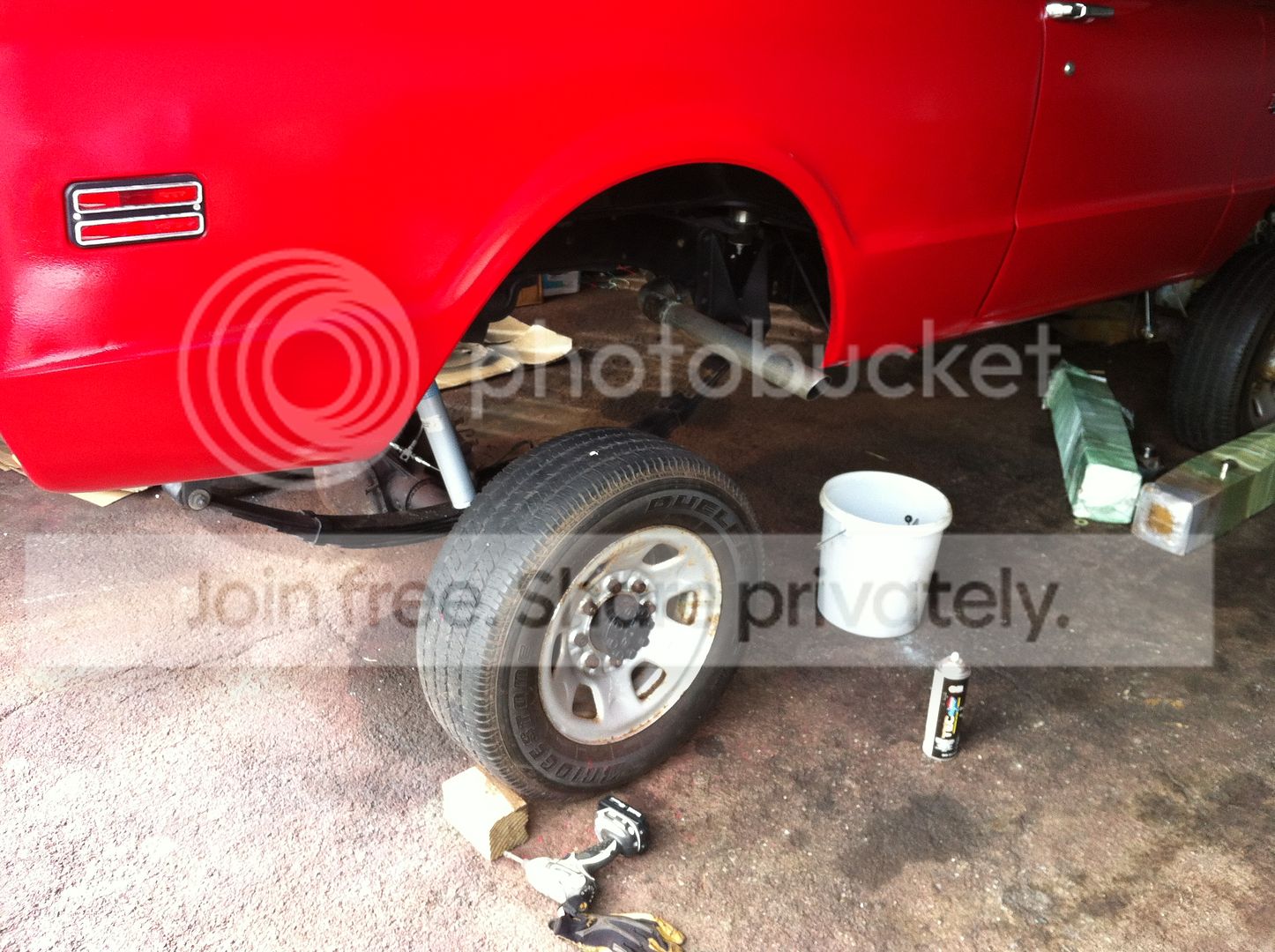

Well I've been hitting it pretty hard this week. As usual things are taking longer than anticipated, but the list is shrinking pretty fast.

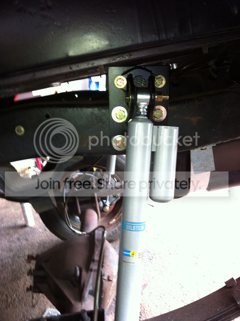

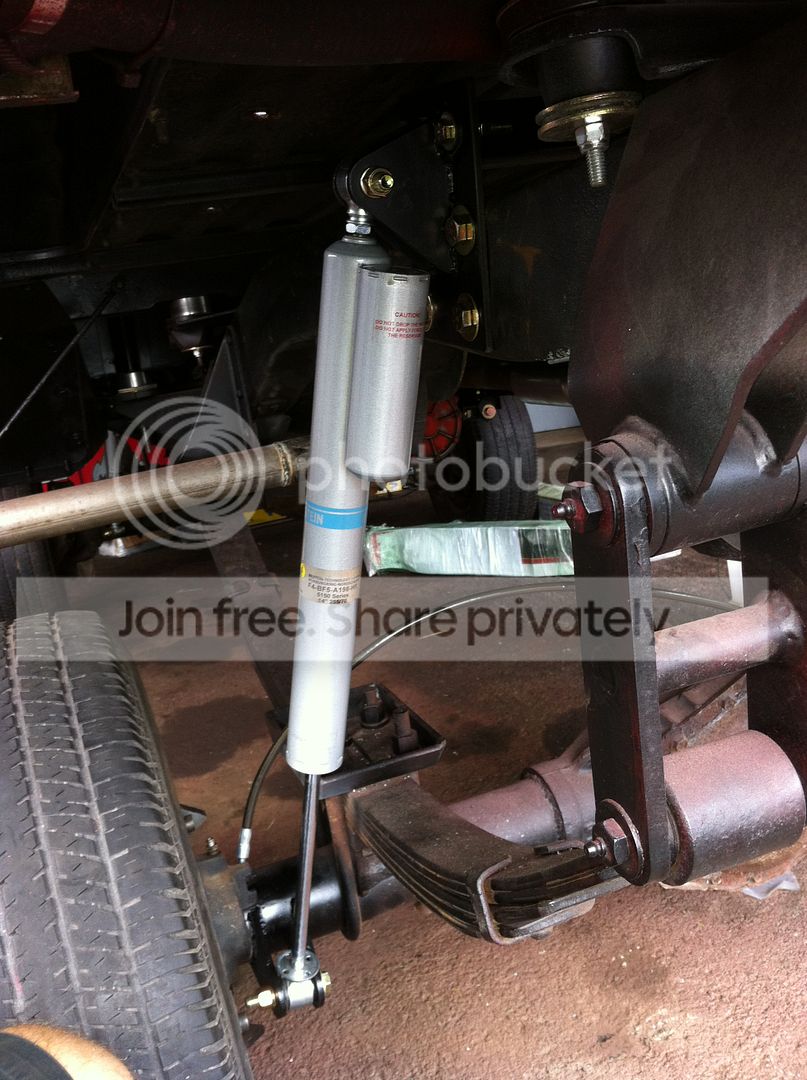

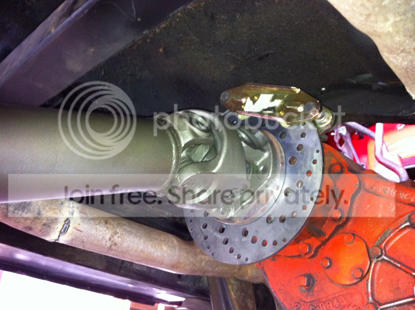

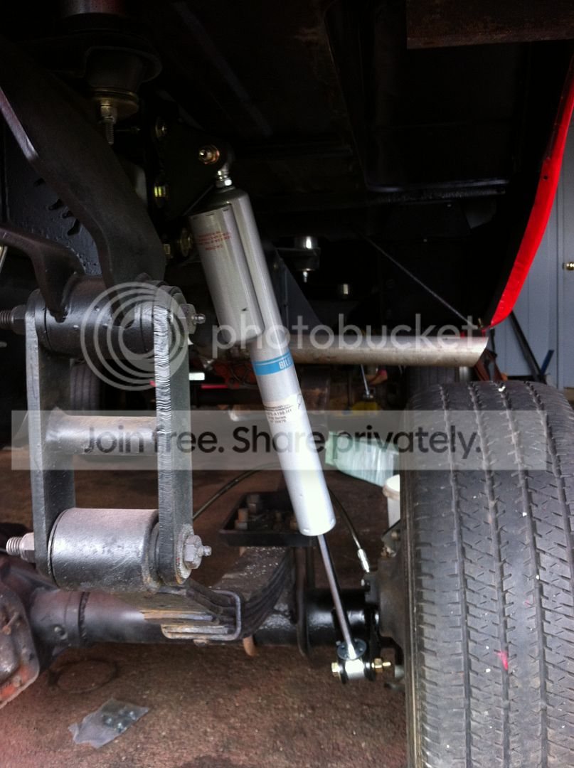

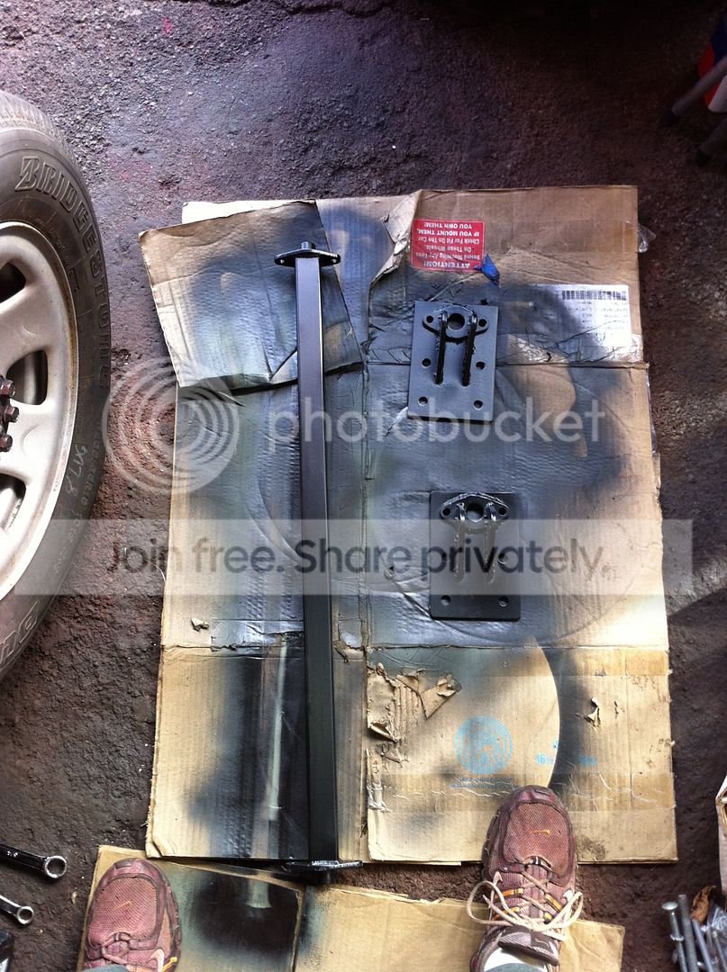

Instead of posting a description of what I've done I'll let the pics do the talking, and make a list of what still needs crossed off.
Change engine oil, fill/bleed clutch hydraulics, replace LF caliper and bleed brakes (hopefully the MC is good), fill radiator, put in seats, put in new throttle cable, install new FUSH kit, put on actual rims/tires, mount front bumper, make new mounts for rear bumper, cut new holes in trans tunnel.
Of that, I expect to get all of it except the last 3 done tomorrow (hopefully), plus fire it up for the first time in almost a year and a half:woot:
My t-case front output flange still isn't here, nor is my windshield:doah:

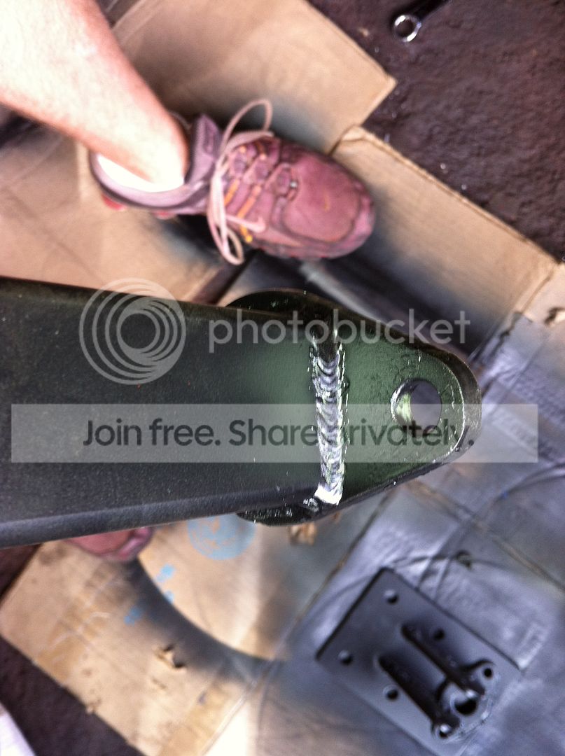

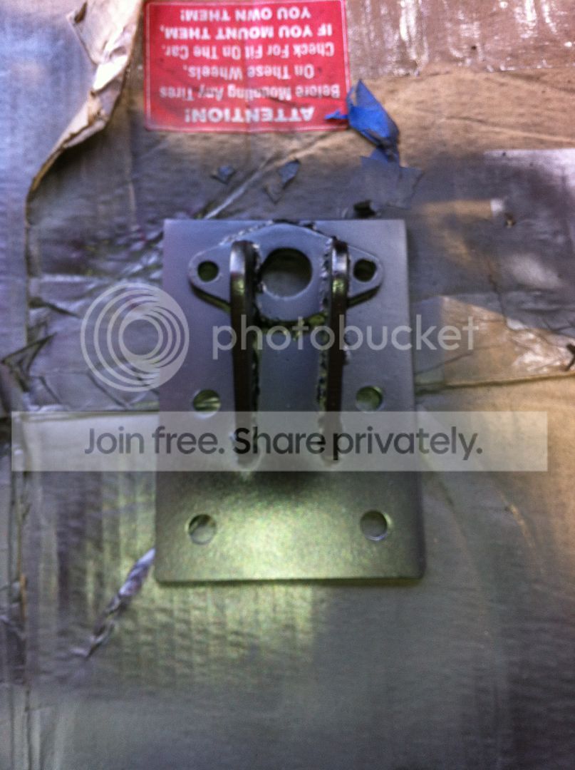

Ok, here are the pics. Oh yeah, I forgot to take a pic of it but I also made a new torque mount for the t-case. I'll snap a pic of it tomorrow.
I've gotten a lot of smaller stuff done over the week too that isn't picture worthy...
Well I forgot to take a pic of the torque mount:doah: Oh well, you guys will live. Once again, didn't quite get as much done as planned/hoped buuuuuuuut....................
