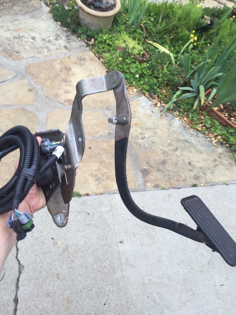

Got the DBW pedal system out of the donor vehicle and separated it from the brake. The pedal has this strange pivot on the arm that renders it ineffective. Should I just weld it closed in the best position or does it serve some other purpose I am missing?
Pretty sure it has to do with the adjustable pedal setup.
If you weld it, i think the action will be weird.
I'd look into the linkage on the adjustable pedal setup, and possibly add a fixed link to the little link nub on that arm rather than fix the pivot.
good idea. I didn't like the idea of having it permanent but it is useless the way it is right now!
that is for adjustable pedal system .
get one from a reg non adjustable system . if I recall you need the black box / tac box that matches that pedal .
and if you were paid member I have pics on how to cut / weld a reg pedal to bolt in stock and have older gas pad on it . its in my 2wd build.
That is from a truck with adjustable pedals. It won't work very well IMO!
A bolt in solution is a throttle pedal for a 94-99 Chevy 6.5L diesel engine. Be aware that the pinout is slightly different from the LS pedals in that two pins are swapped on the connector.
fyi I had one of those and it was going to take up so much room under the dash .
that's why I went reg pedal setup .
and the newer stuff stuck the pedal pad so far out off the fire wall . that's why I cut it down and made it short .
