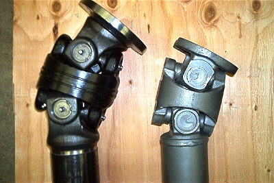

Thanks guys I have 8" bds springs with built in degree shims which is worthless. I have to get correct ones I guess ill get an angle finder and try to figure it out. I got the 42* cv front shaft from Jess at high angle which is bad ass but I know I still need a shim.
