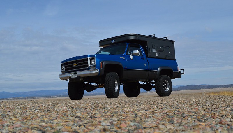

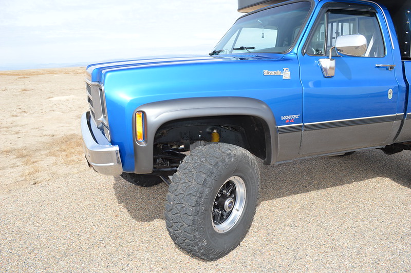

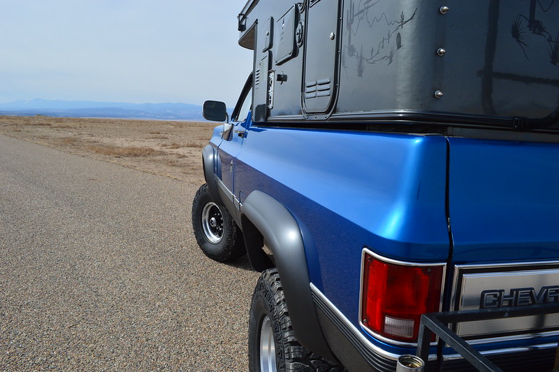

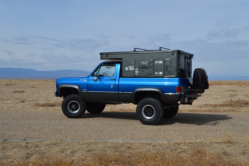

Well, we are 1 week away from departing for Death Valley and I have been real busy doing maintenance and getting things dialed in. One thing I recently had to change were the fender flares as the new tires and wheels are just wide enough wreak havoc on the old front WARN flares when turning and hitting a bump so I upgraded to Xenon flares. I originally wanted Xenon flares 10 years ago when I installed the WARN’s but the Xenon’s were on intergalactic back order at that time.
I love these Xenon flares but they are extremely finicky to install as they must be installed on a nice sunny day to allow some latent heat absorbed into the flares and fenders. On the other hand, you don’t want them to soak up too much sun or they are like trying to mount a wet noodle. It took 3 tries to get the right front flare mounted and twice for the right rear. I even called and spoke with a really helpful guy at Xenon to seek advice. At the end of the day, I ended up buying a fresh roll of ½ 3M double sided tape from the local auto body supply store which between the fresh tape and a warm sunny day to install rubbery flares cured the install issues. All hassles aside, the Xenon’s are worth it. The part number for the flares is (73-80 C/K) 8390 and cost $361 through 4WP. The old rear WARN flares are going on the Suburban and I’ll have to order a set of new front ’81-91 flares to match.
Think they look pretty cool. I really like the port hole for the side marker light. Notice how the Xenon flares do not have a splash guard, of sorts, that sticks down past the rocker panel like the WARN’s did in the pictures above.

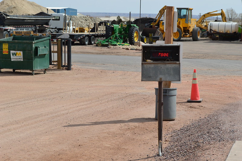

I ran by the scale today as well. It came in right at 7,800 lbs with two full tanks of fuel. By the time the gear and supplies are loaded we’ll be pushing well over 8,000 lbs again this year. So much for trying to shave weight off this thing…..

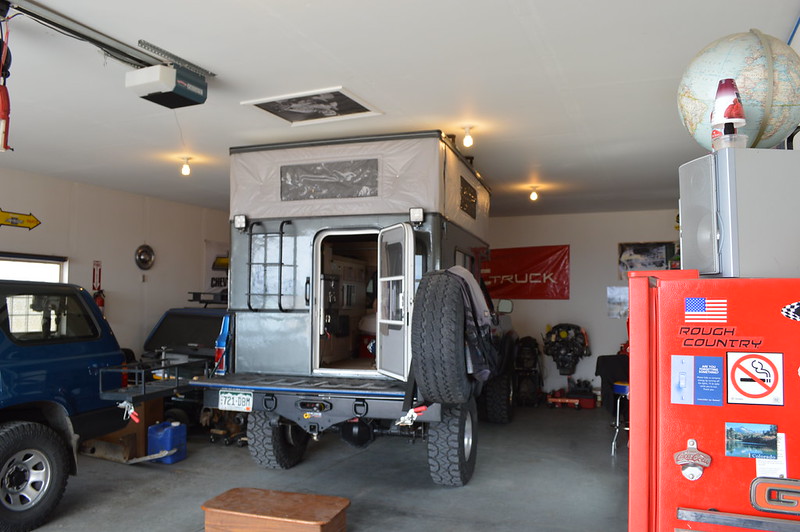

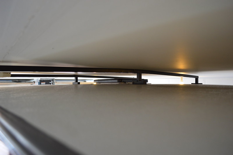

With the truck now ready for the road it is time to start loading up the camper. In order to open the top in the garage the truck has to be parked in the middle to striatal the lights.
You can’t slide even a piece of paper between the ceiling and roof rack :haha:

The new flares look great! I take it the tires no longer rub?
Not yet. I trimmed them a bit and massaged the fender bottoms with BF dead blow Hammer. We should be good now. :haha:
Hell before I couldn't even pull in my driveway without the tires taking a bite out of the WARNs.

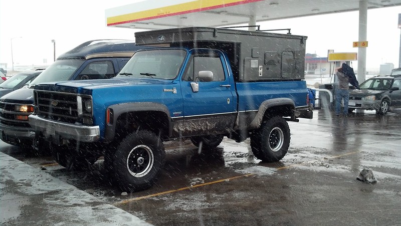

WOW, What a perfectly sucktastic day for a big road trip! Rode the old Chevy 827 miles today in a friggen snow storm, 8 hours of major wind storm and horrible interstates. We left around 6:45 AM in a snow storm where the roads were a total ice rink from home all the way to Raton, NM. Lost a lot of time going through that. Once we started rolling down the New Mexico side of Raton pass the sun was out, roads were dry, birds were chipping, palms trees sprouting….blah blah blah. That good travel weather lasted a whopping 40 some miles until we hit Springer, NM. From Springer to the practically the Arizona border the wind was atrocious. Talk about white knuckle driving for an entire day! Then I ran into an issue with the fuel gauge where it doesn’t seem to want to read proper fuel levels in either thank. I suspect some road deicer got into the dual tank switch valve connector and is causing resistance issues. I carry terminal cleaner in the tool cashe so I plan to clean up connections in the morning before we hit the Mojave Rd in hopes that fixes gauge woos.

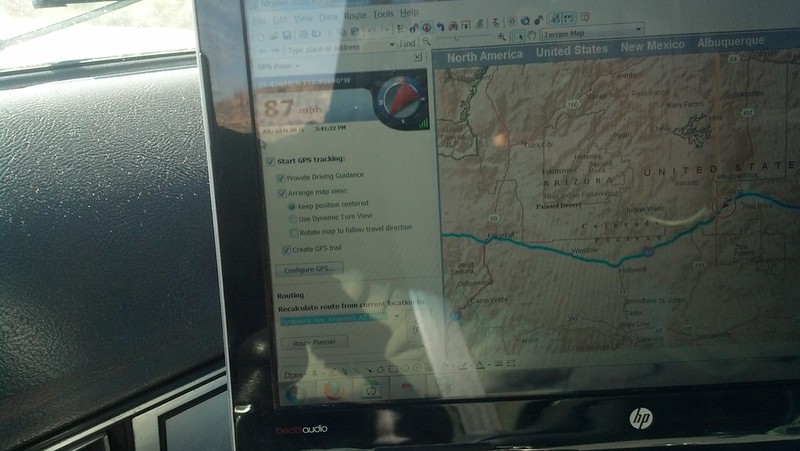

Started making some decent time once we got in to AZ. The big old dog cruises and handles very well in the upper 80 MPH range :haha:

87MPH Thats cliping along good in a square body with a pop up camper. :haha: :thumb:
:haha: Yeah, you would be surprised how well the ole K10 cruises down the road. One wouldn’t expect it to drive and handle so well at highway speeds. The 8.1L and OD trans allows it to fly down the highway just like any late model modern truck. I’ve had it as high as 93 MPH passing cars on interstate before. The tcase screams like hell above 85 MPH though. More on that later.
