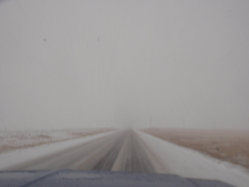

100 miles of this caca was no way to start a vacation

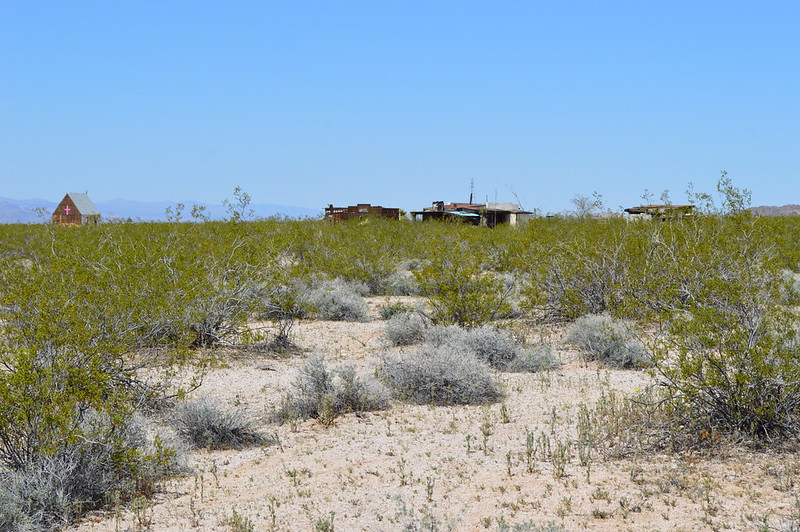

Some neat old buildings scattered about. This was probably on old mining camp

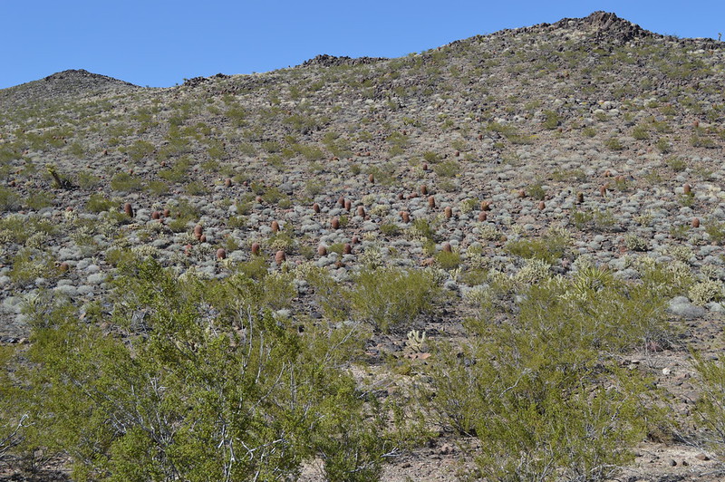

Check out all of these barrel cactus. They were all concentrated in this one area.

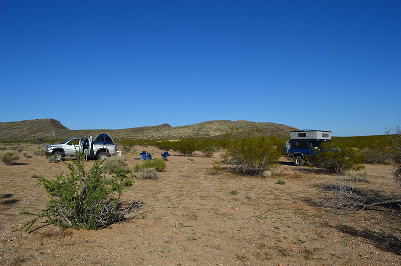

Camp site 1 on the Mojave Rd. This night I felt a cold or something coming on as I could not get warm. More on that debacle later. At this point we are about 25 miles into the Mojave Rd with around 115 miles yet to go.

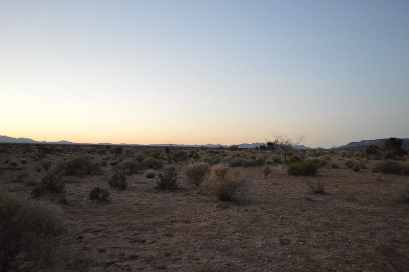

This spot in the Mojave doesn’t look much different from where I live in Colorado
The Fort Piute ruins in the pictures above are just on the other side of that hill
