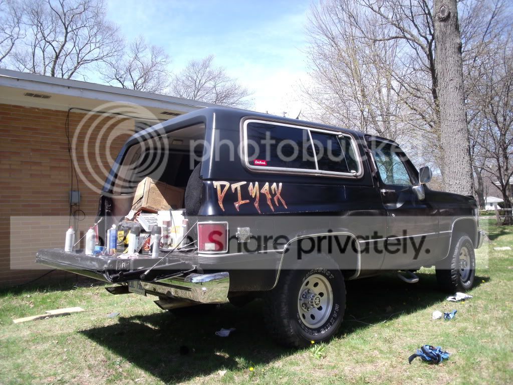

Picked it up at fall last year or so, just kinda been slowly fixin stuff here and their, and dropped a 408 sbc in it, new shocks, nothing too fancy.

Basically when I got mine.

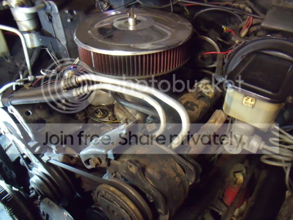

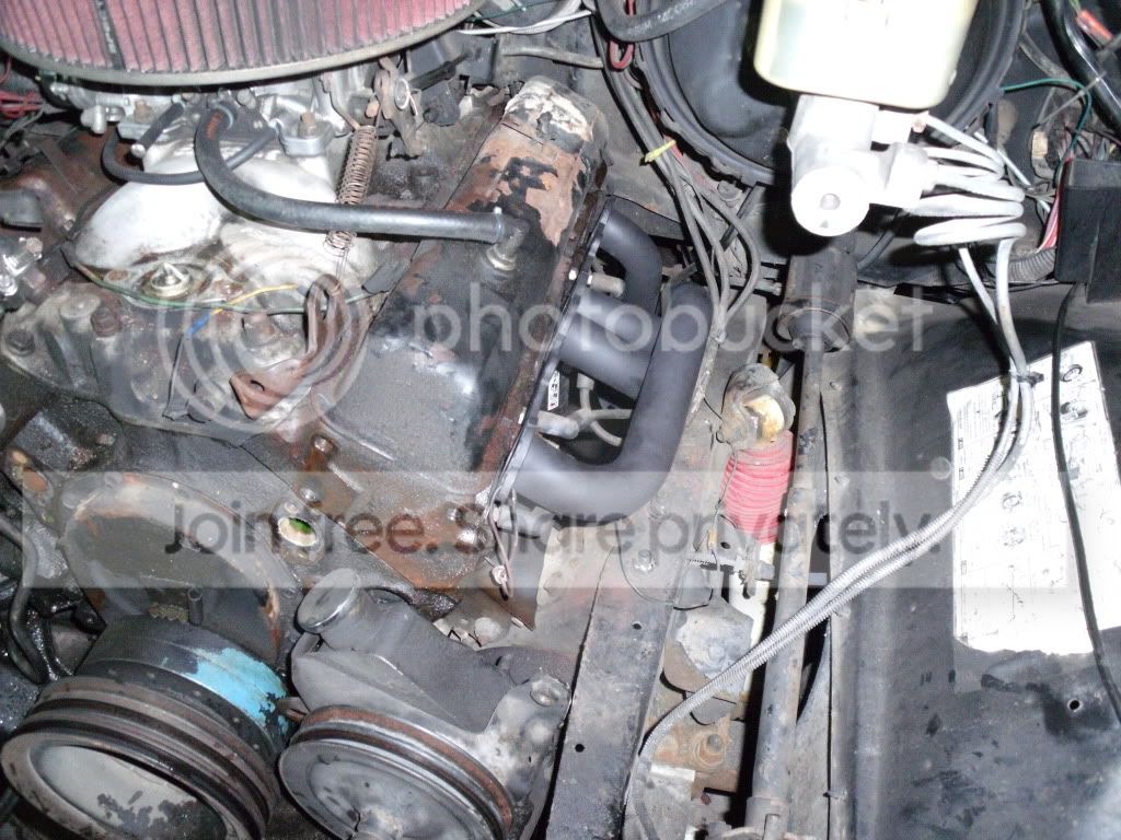

Had a 305, it was makin lots of weird noises, getting 6-7 mpgs, piece of junk had to go...

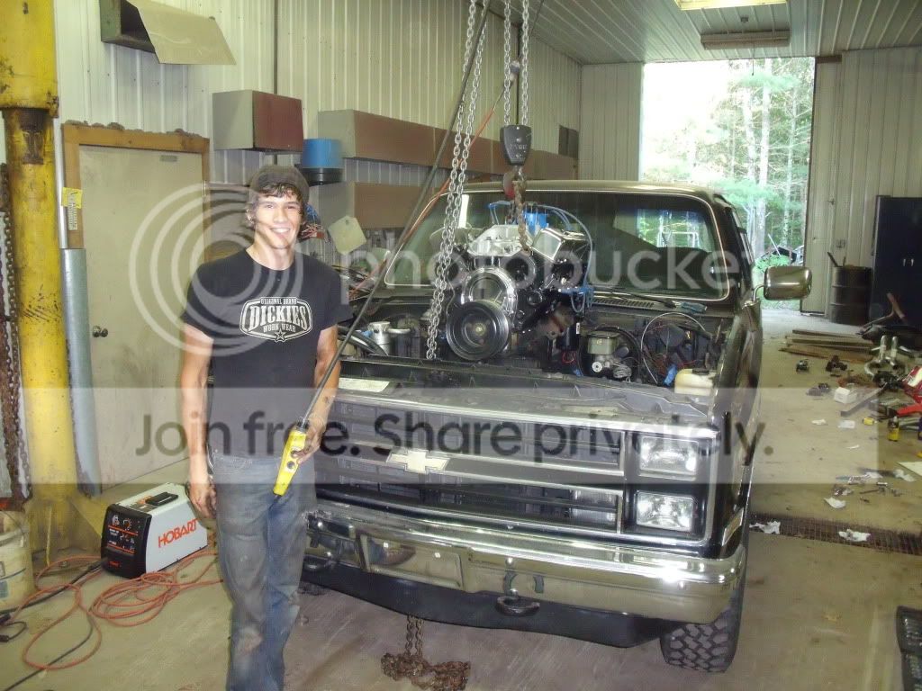

So began the very long process of finding a good engine, ended up talking to a buddies friend that has been building them for a while, he saw a post I put on FB of a 350 crate on CL a guy wanted $900 for. He said he could build me a 408 that he had already bored out with no home for the same price and that I would know I was getting a good motor and not just something somebody coulda slapped some chrome and paint on. So I said go with it:thumb:

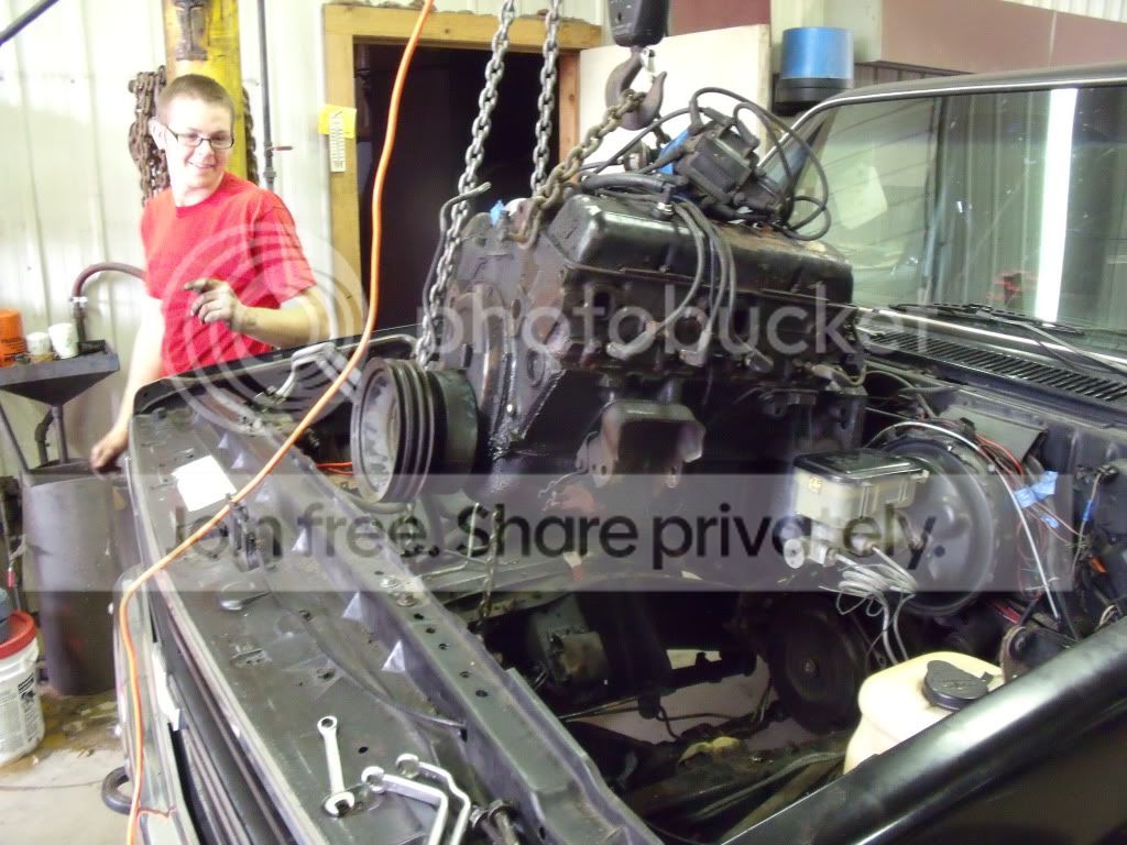

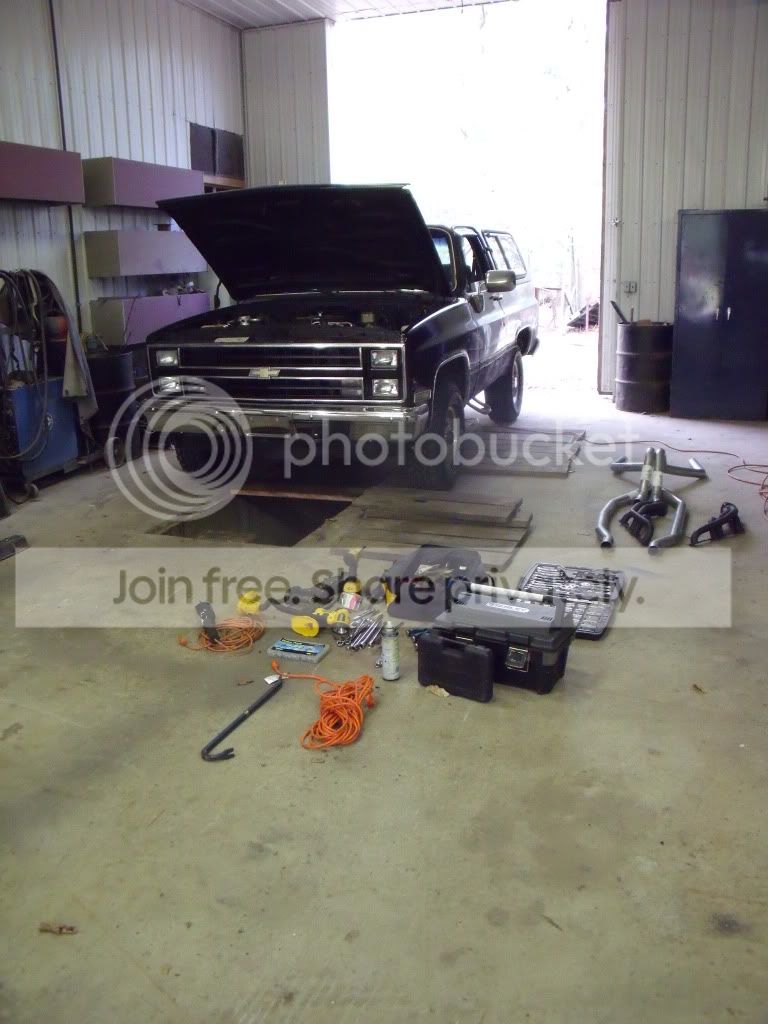

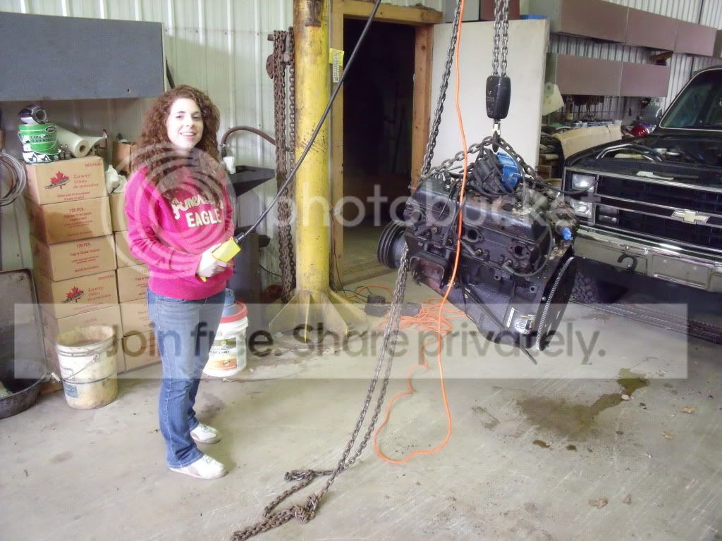

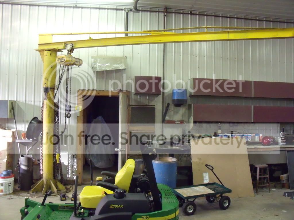

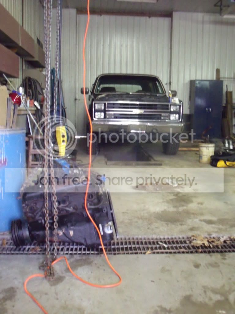

Started tearing the 305 out at my bossed house, he has a nice work shop with swivel hoist and pit (shhh dont say anything bout the pit :waytogo:)
Had alot of help from my buddy nate
And my lady even came down to help a time or two... MMMM SEXY :)
dats me lol

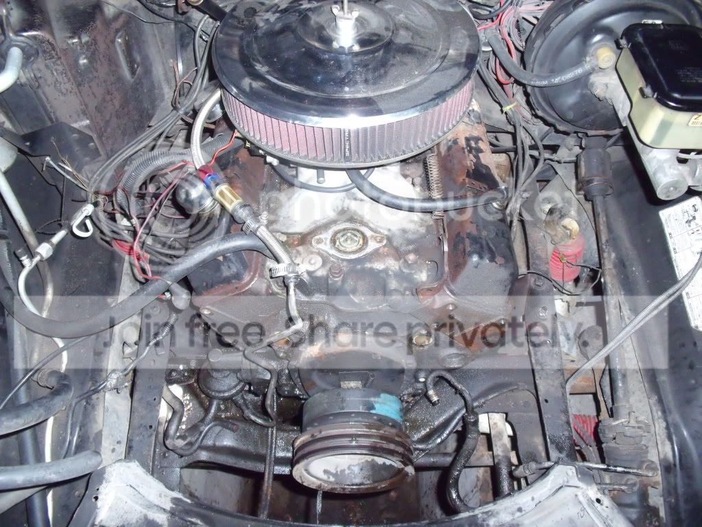

Goodbye 305

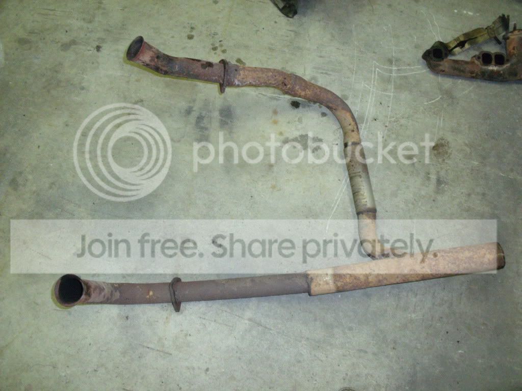

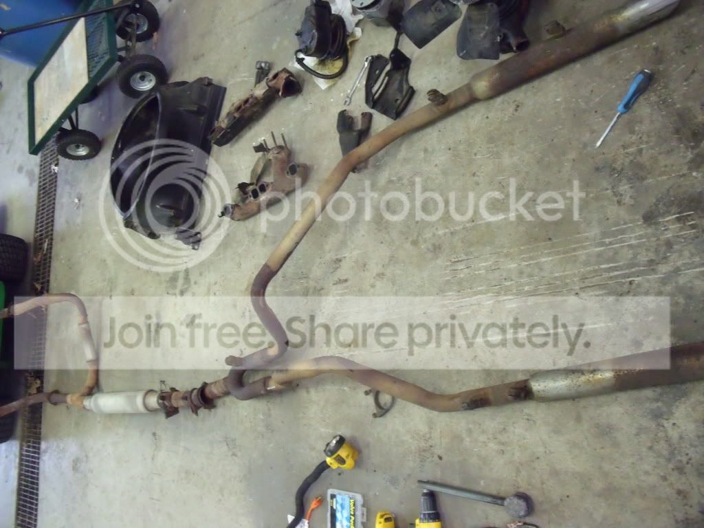

Old junk exhaust

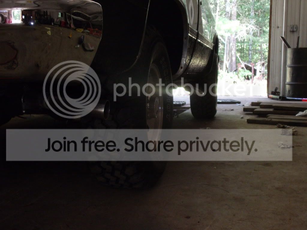

New perty 2.5" mandral bent exhaust i scored for $80

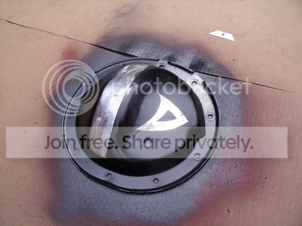

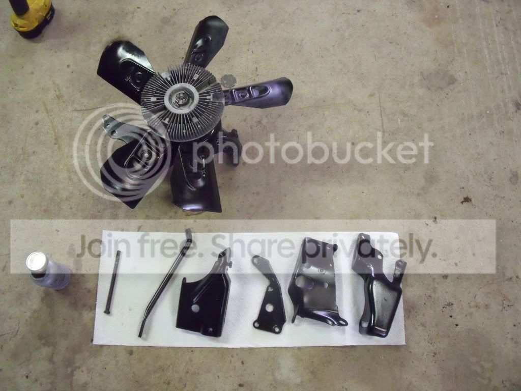

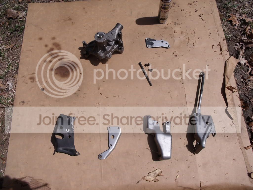

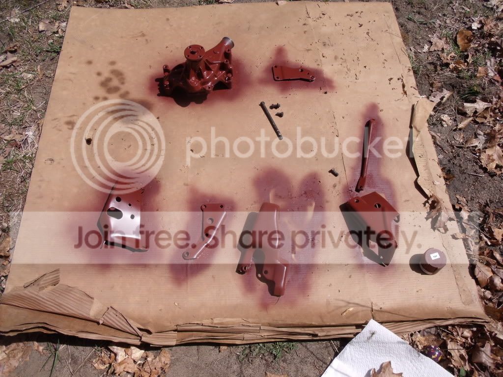

Took all brackets and blasted, lady helped again:thumb:

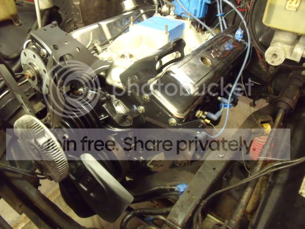

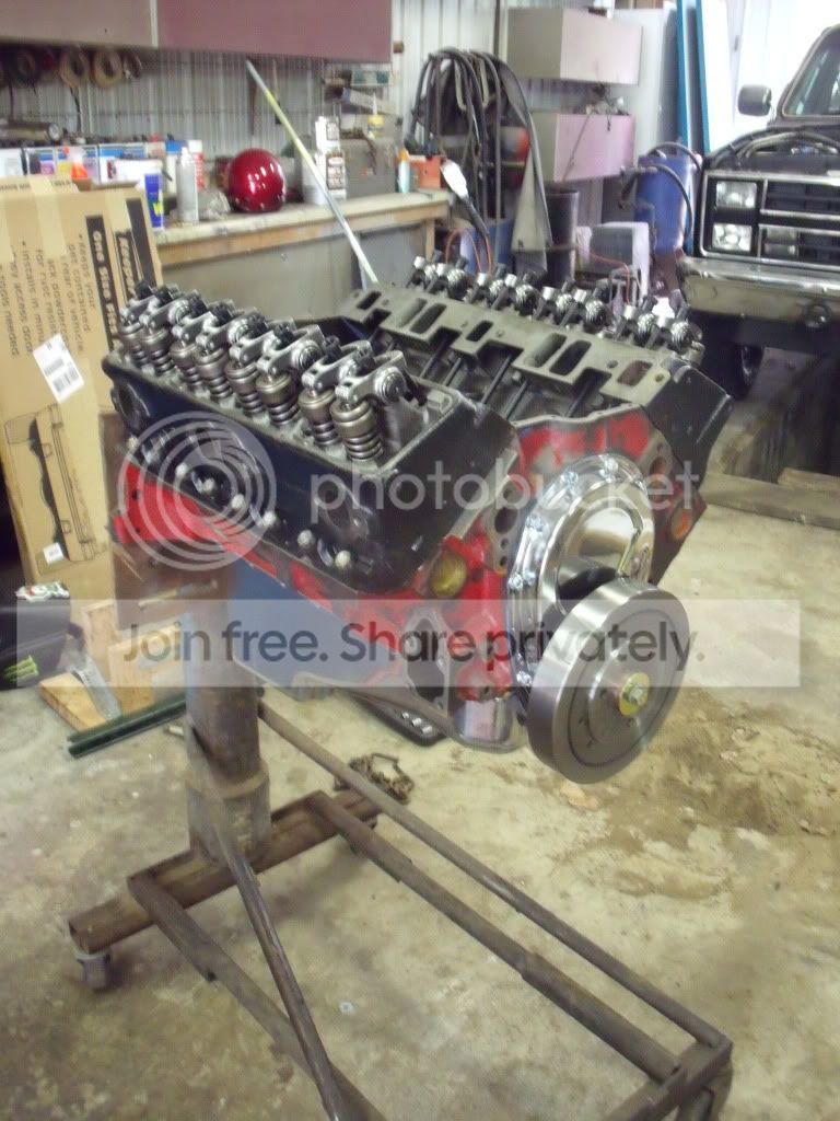

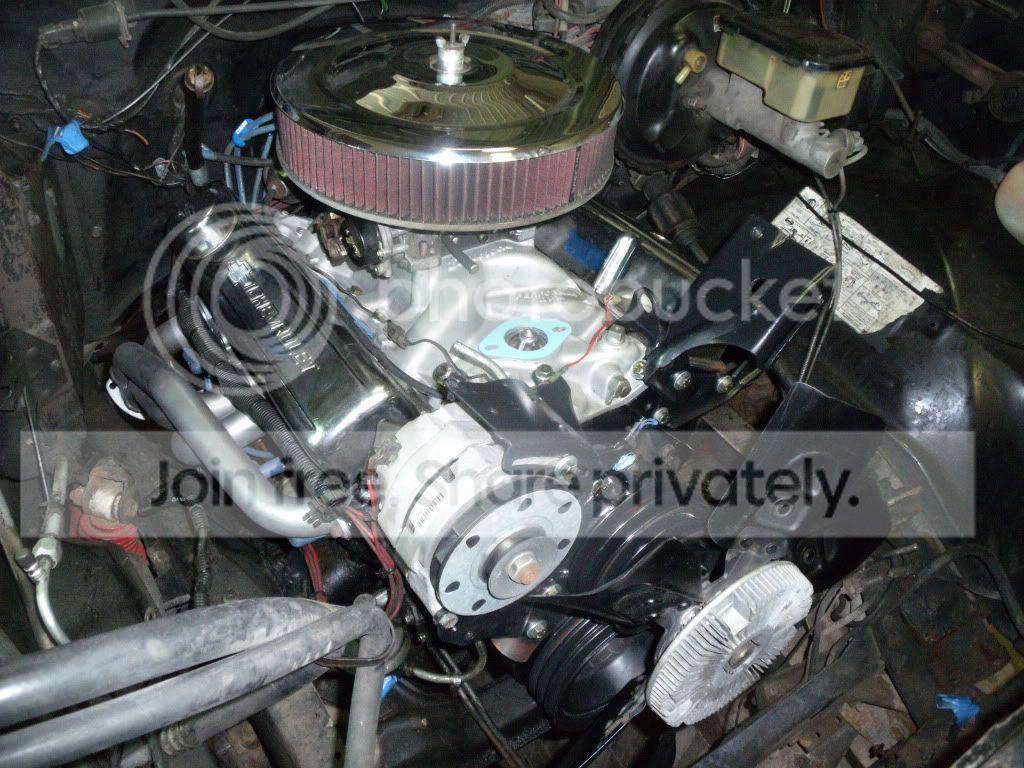

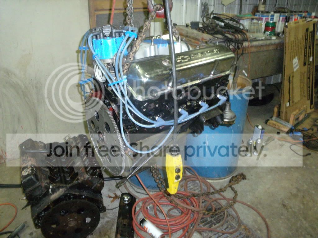

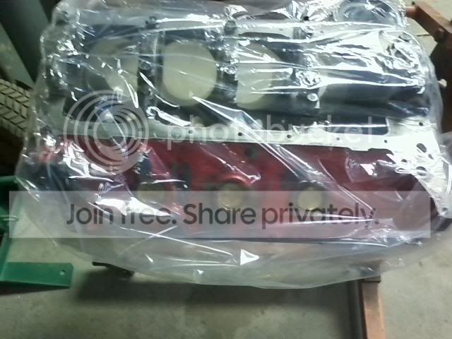

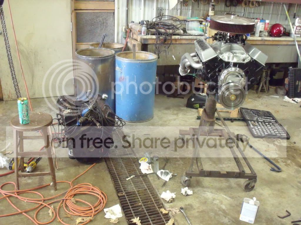

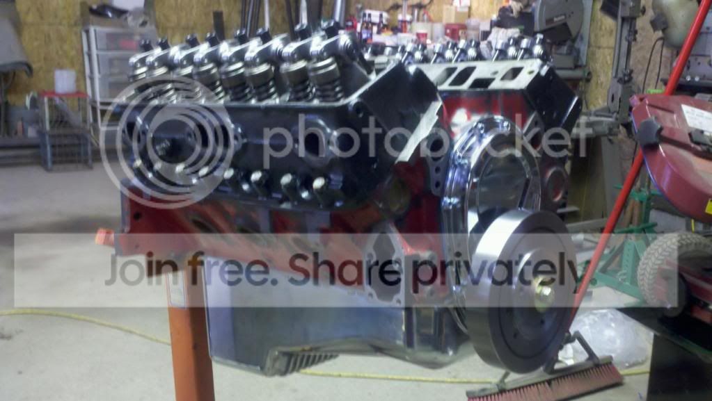

After months of waiting I finally got pics of the 408. 400 sbc Bored .040 over, summit 1103 cam(dont recall specs at the moment), new everything plus stainless steel roller rockers, polished alluminum oil pan, pro street harmonic balancer, edelbrock performer rpm, edelbrock 1406 carb (off the 305), stock heads completely rebuilt by some race engine builder in Mt. Pleasant MI. Nothing too fancy, just new and 408 SBC just sounds cool:thumb:. It was $900 for the rebuild plus another $400 with roller rockers, cam, oil pan. So $1200 for new motor not bad at all.
Then the day finally came, I got to go pick it up :)
Out with the old, in with the new

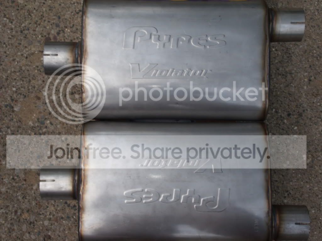

Then I made my $4XX order from summit. Royal purple break in oil, royal purple synthetic 15w40, thermostat, spark plugs, motor mounts, Stainless Pypes Performance Violators, and WIX filters:bow:
This motor will run Royal Purple as long as im around:thumb:
Yeah, they are loud:thumb:
Ended up not being able to run the valve covers I had because they were hitting on the roller rockers. Picked these up, with the Felpro steel insert gaskets they no leak (highly recomend these gaskets for valve covers and oil pan)

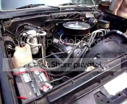

Then judgement day arrived... BREAK IN DAY:eek1:

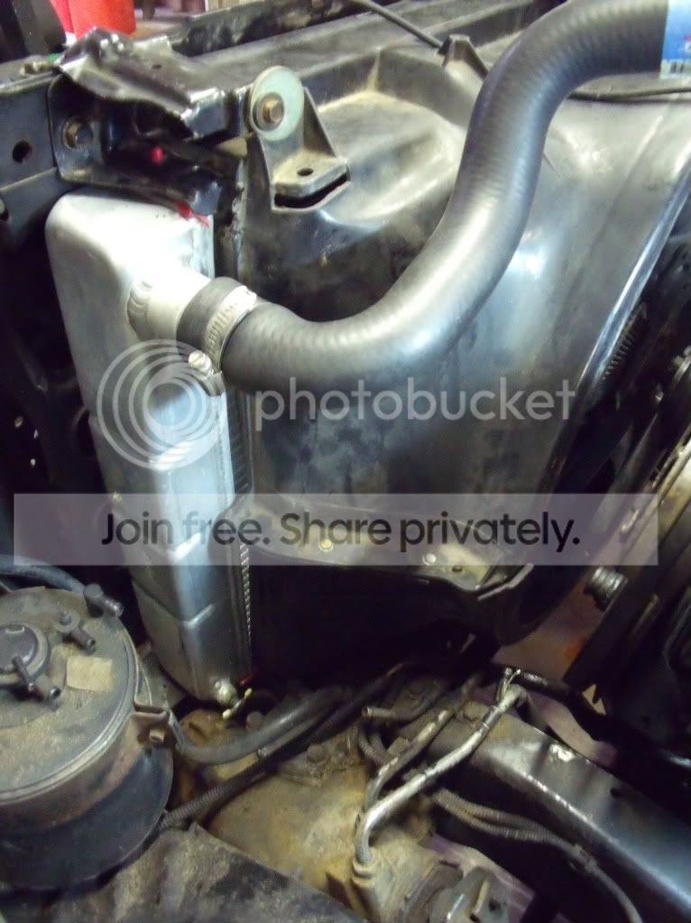

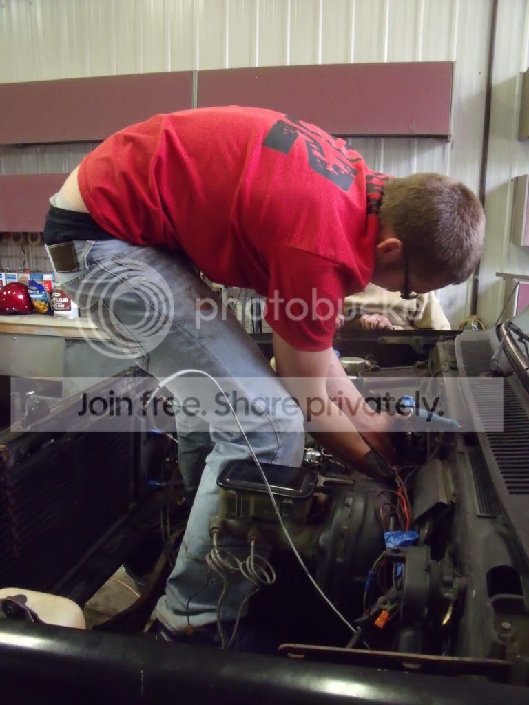

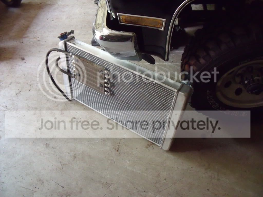

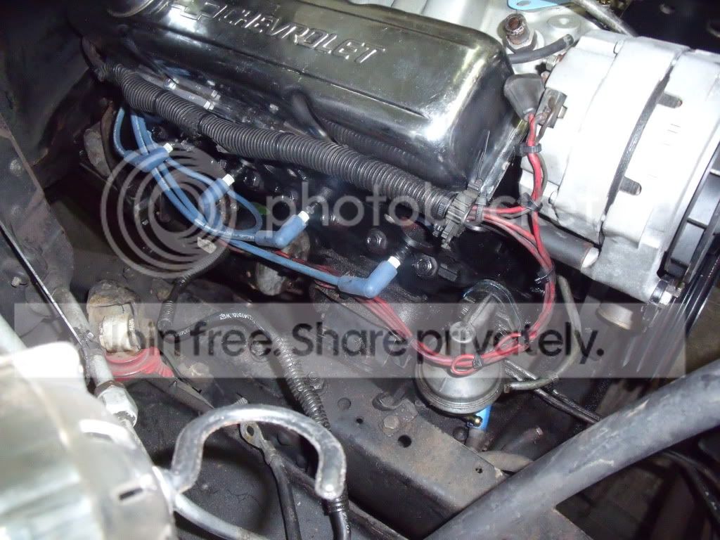

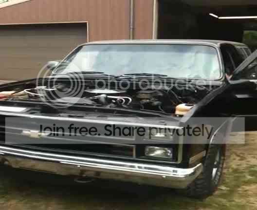

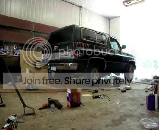

Well went to fire it up, lots of fire and boom sounds out of the open headers:eek1:, checked compression in #1 cylinder and found out the Dist was 180* off, spun it around fired right up............ Then the radiator blew up and blew about a gallon of water all over everything..:doah:
Went home all bummed out and started looking up radiators, my buddy stayed the night and was bored searching craigslist when he found a scottsdale for sale with a 2.25" core Northern alluminum rad with internal and external tranny cooler. Called the guy, he said he paid $400 for it new, put it in then his engine blew a month later and he wanted half of what he paid.
Picked it up next morning for $200:woot:
Went down and installed. Its sexy:thumb:

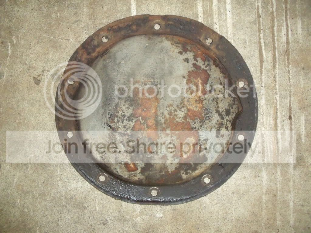

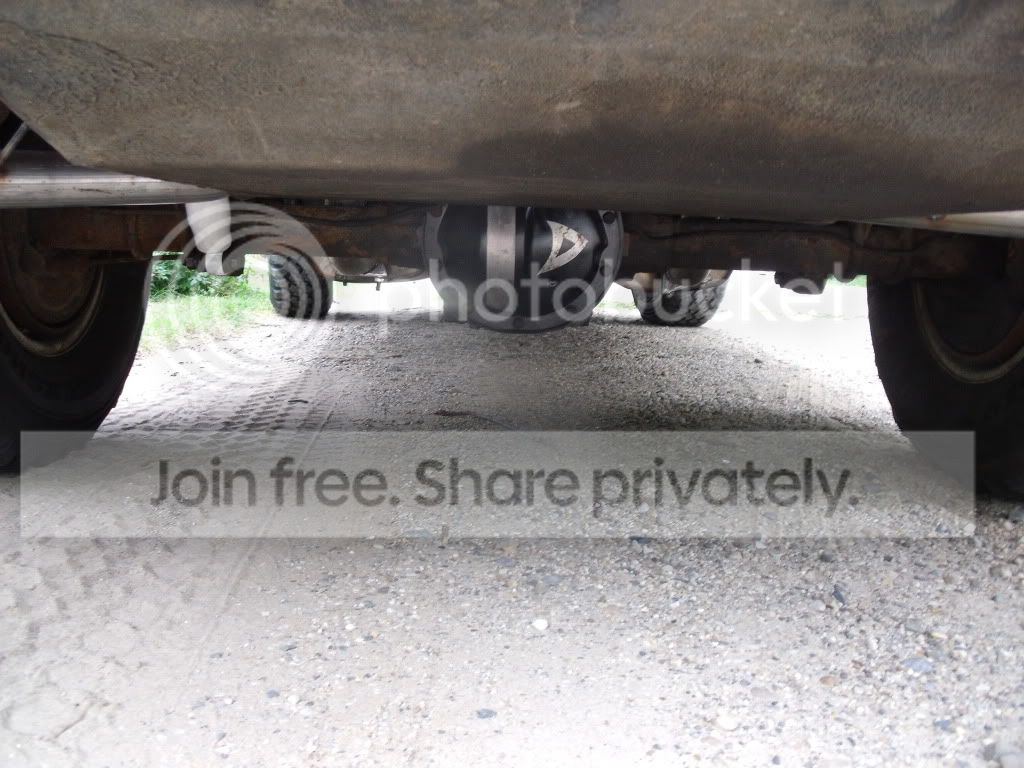

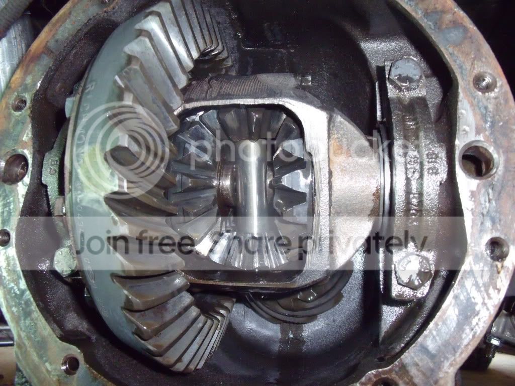

Ring gear says richmond, so its been rebuilt:woot:and the gears look fantastic

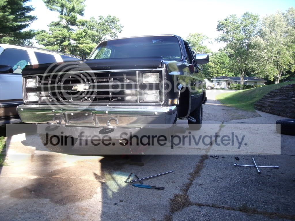

Did front bearings

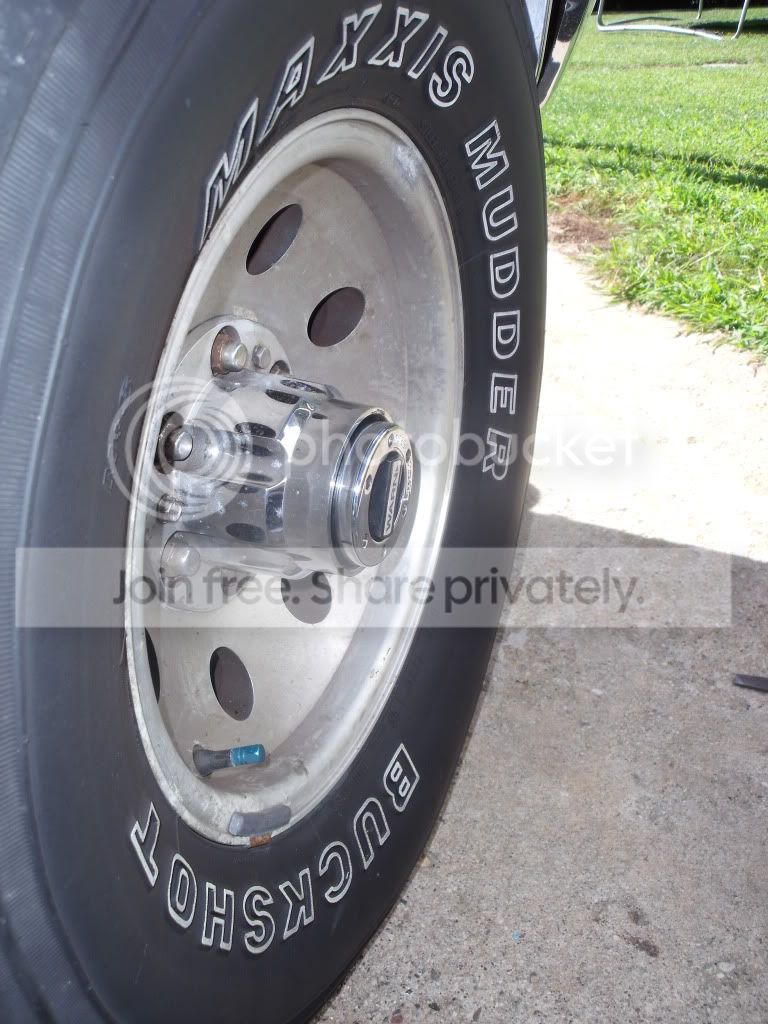

Got a deal on some warn hubs
Ready to rock
Time for some silver lake sand dune action
(headliner shot courtesy of my lady :waytogo: Can you tell the trucks from tennesee?? lol)
Welcome all, to SILVER LAKE MICHIGAN, my favorite place on Earth:thumb:
Me and my dad
Let dad take her for a spin
2 wheel drive test and she climbed better than alot of people in 4 wheel:thumb:

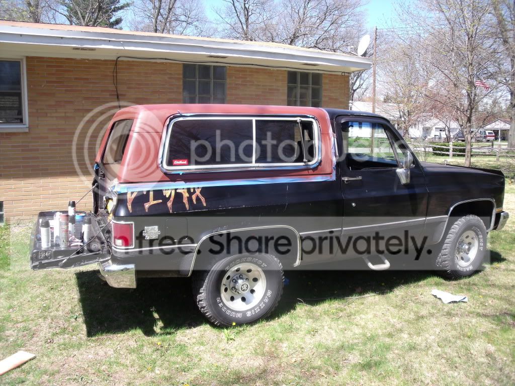

I put a new top on somewhere in their as well, the old one was pretty beat up and lots of cracked windows
Lots of help from friends with sanding

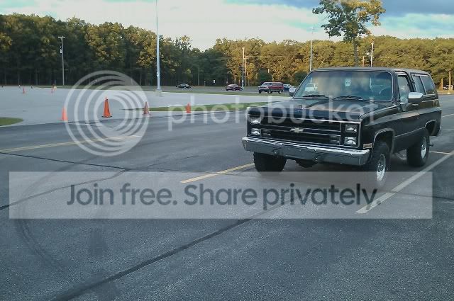

No burnout action really, got one pic of one I left in the college parking lot..:waytogo:

Trucks looking good and the engine must be a nice change from that 305.
Im liking the swivel hoist and the homemade engine stand too

This engine is night and day from the 305, I had to get used to the pedal at first so I didnt rip the ol 10 bolt out:thumb: Also it gets better mileage which is a plus, and when I get a qjet I should get even more out of it.

How long did it take ya to swap out the hubs?
I'll keep it short and simple. Good build up, pretty motor, beautiful truck, good looking ole lady but do you wanna borrow my hair clippers to trim that mane up a bit?:pimp:
Lol you talkin her hair or mine?? Thats not very good pics of her, I got some betta ones but you guys cant see:rolleyes:.
And the hubs, well the one side took about 10 min, the other side... well all 6 bolts stripped and I broke a hardened bit off in one so I couldnt drill the bolt out so I sawzalled the hole hub off lol. After that it was a cake walk.
Thats not very good pics of her, I got some betta ones but you guys cant see:rolleyes:. And the hubs, well the one side took about 10 min, the other side... well all 6 bolts stripped and I broke a hardened bit off in one so I couldnt drill the bolt out so I sawzalled the hole hub off lol. After that it was a cake walk.
Talking about your hair, but if you decide to trim hers take pics and video. :D
How you liking the warns? I'm in the process of doing that myself.
Oh heck my hairs short in those pictures man:pimp:
I like em, got a killer deal on the set for $40 for the set. I really like the quarter turn to lock them in, and the look and feel compared to the mile markers is much better. Much beefier. They worked at the dunes great.
