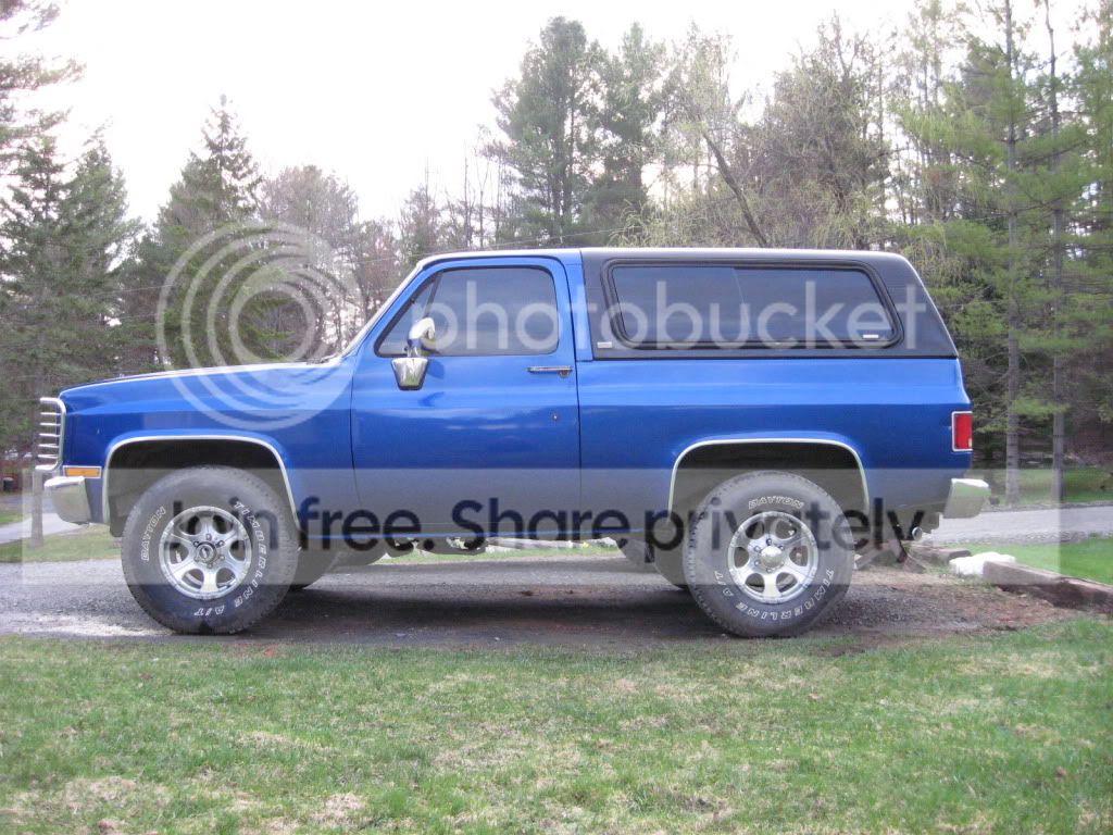

It's a 1990 K5 Blazer from North Carolina. No rust whatsover and runs like a champ. It did need some TLC to get to this point though.

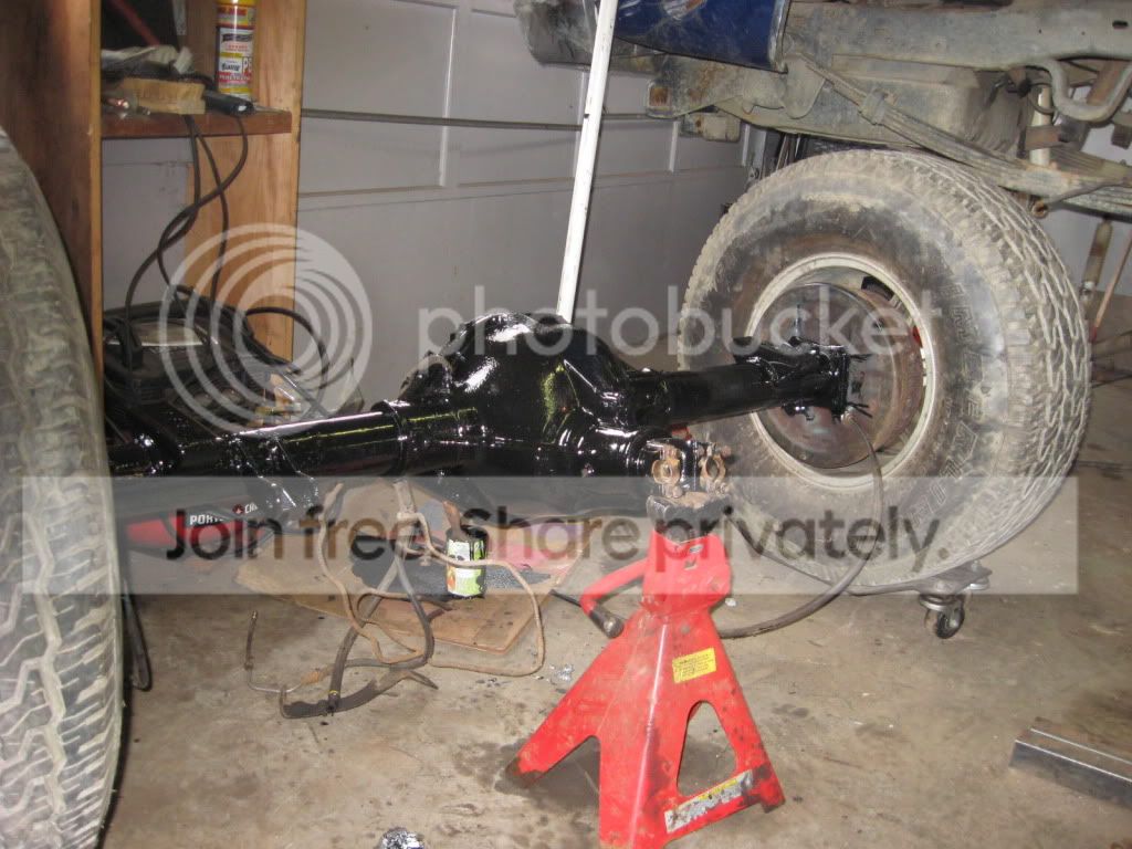

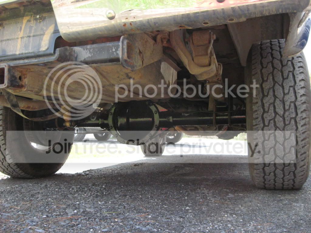

The main reason for the low price was the rear axle was damaged from sliding into a barn. The rear axle shaft was snapped off and the brake drum and backing plate were unusable. Did some research and found out about the 14 bsf 6 lug axle swap. Found one on a local forum with the right axle ratio, put some new spring perches and shock mounts on it.
The yoke from the stock 10b swaps onto the 14bsf, the stock ebrake cables work, and brake lines hook right up.

are those side windows in the top stock? I don tknow that i've seen them before. or is it just because of the lack of the small wings:dunno: their sweet either way.
Well if it makes anyone feel better, I have put more than I paid for it into it between the axle, spring mounts, and other miscellaneous expenses. I could also put a pic up of the other side where it hit the barn. The K5 has a name already, Dr. Jekyl and Mr. Hyde. because one side looks super nice and the other side is a little bit scary. Still feel like it was a good score though. Everything works, the interior is in really nice shape (other than the seat belts), and it has a decent CD player. Sure beats the previous military versions that I never seem to find the time to put a radio in.
The rear windows are what it came with. Dunno if they are stock or aftermarket.
Oh yeah, and I spent about 2 hours with a box of SOS pads on those wheels (brake dust, minor corrosion, etc.) to get them to look like that.
The rear windows look aftermarket since there isn't a visible mount for the flapper window thing. Mine were factory and I took the flappers off. There'd either be a notch where their mounts were or the mounts themselves still stuck there.

Thanks. I am pretty psyched. It is definitely the nicest K5 Ive owned. Especially, living in the northeast. Just replaced the broken gas tank strap so I can actually drive it around now. We will see how it likes highway speeds.
