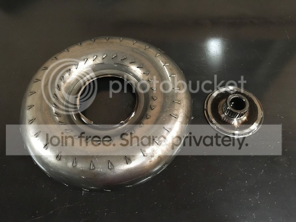

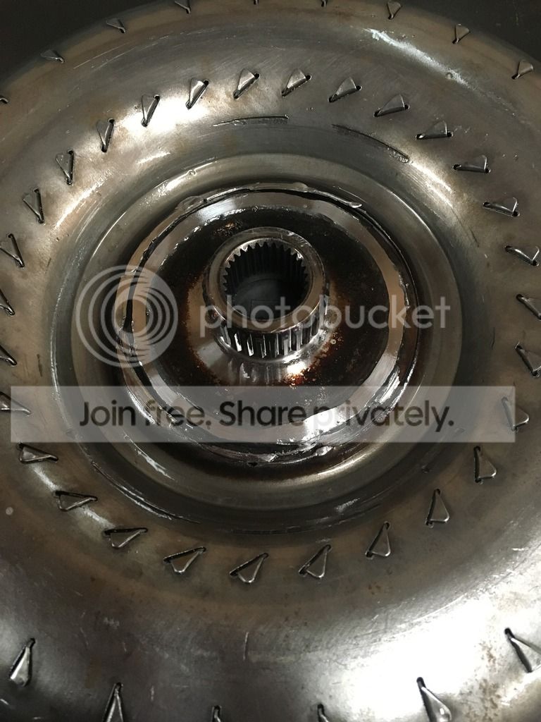

I confirmed that the issue was the torque converter. The hub is broken out of the turbine. I've never been pleased with this converter and I was planning on replacing it anyway, so I cut it open to see what was going on. Looks to me like it had broken before and they did a cruddy job of repairing it when the converter was rebuilt.

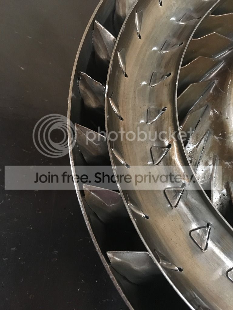

It also looks like they bent the fins on the turbine by hand to set them to a new angle.... This will be my last purchase from Monster
That is a replacement hub, they just didn't get a good penetrating weld on it when it was installed. It also looks like the turbine was machined too thin in that area and may have contributed to the failure, there isn't much meat there to begin with. They should have brazed or tig reinforced the fins on the turbine, I'm guessing this was some kind of mass produced part and not a custom built unit.
