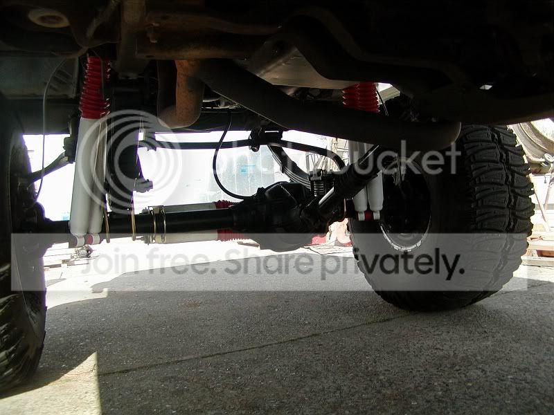

Mine's got the factory dual shocks, but when you order aftermarket shocks (Skyjacker at least) and specify it's for a dual application, you'll get a set of bushings that are offset and longer that take the place of the spacer. You can see them in my picture.
(Factory setups would have a steel spacer that goes over the bolt in between the two shocks, taking place of the big red bushing that is visible here.)
Well, if you've got a big bumper/winch/plow or something heavy like that up front, it'll give a nicer ride. Honestly, mine's a street truck, so it's more for looks.

If you can would you plz take some close up pics for me of both ends of the mointing of the shocks. PLZ AND thanx if you can
