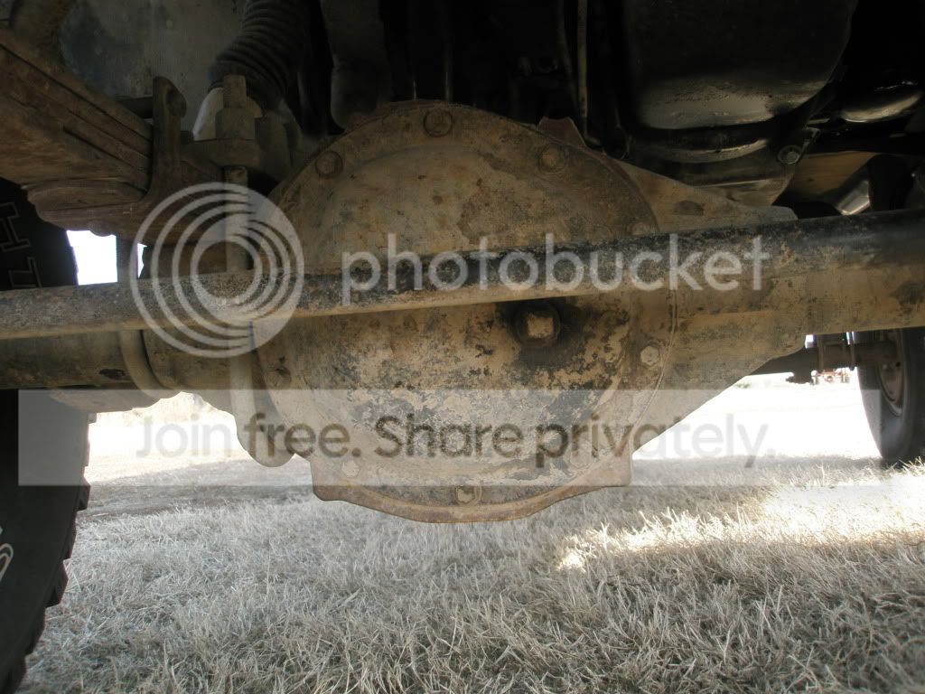

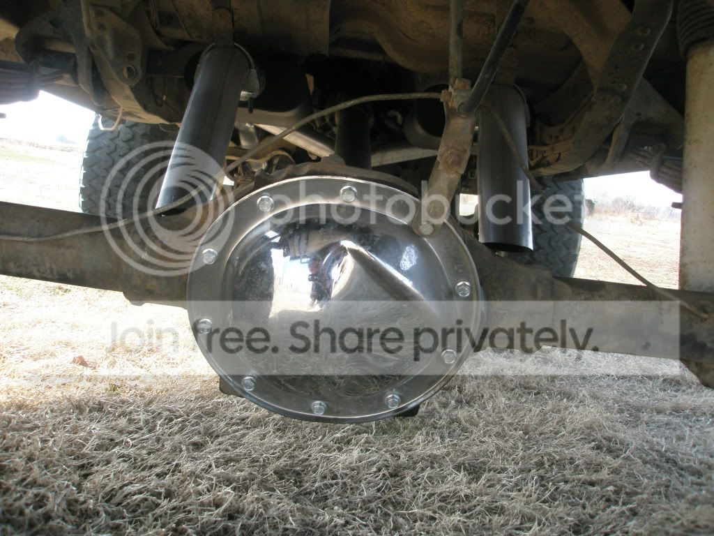

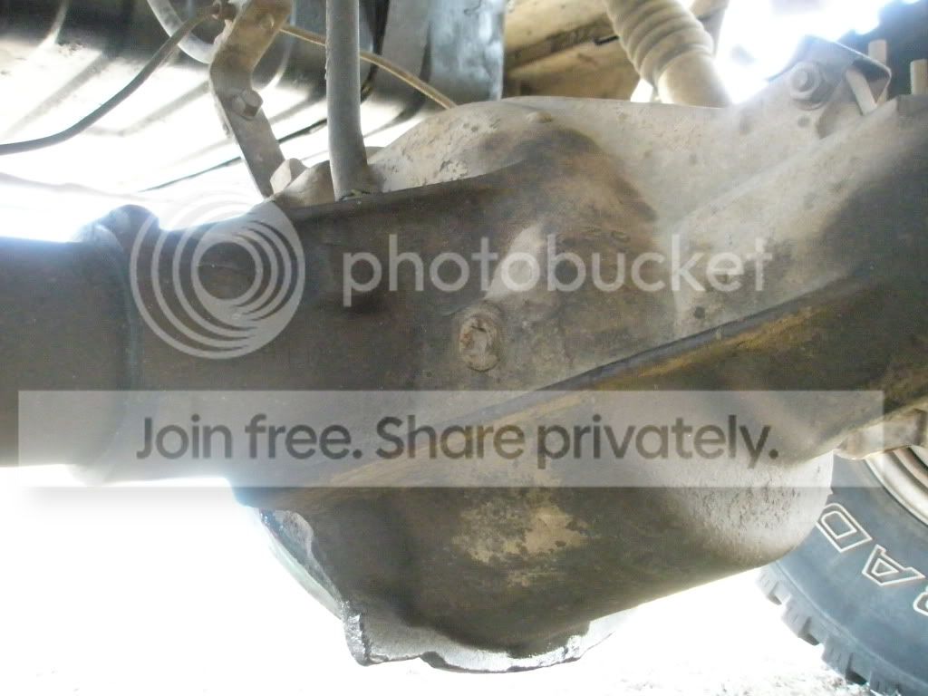

Ok we'll start with the axle's:
Rear GM 10 bolt
Front GM 10 bolt

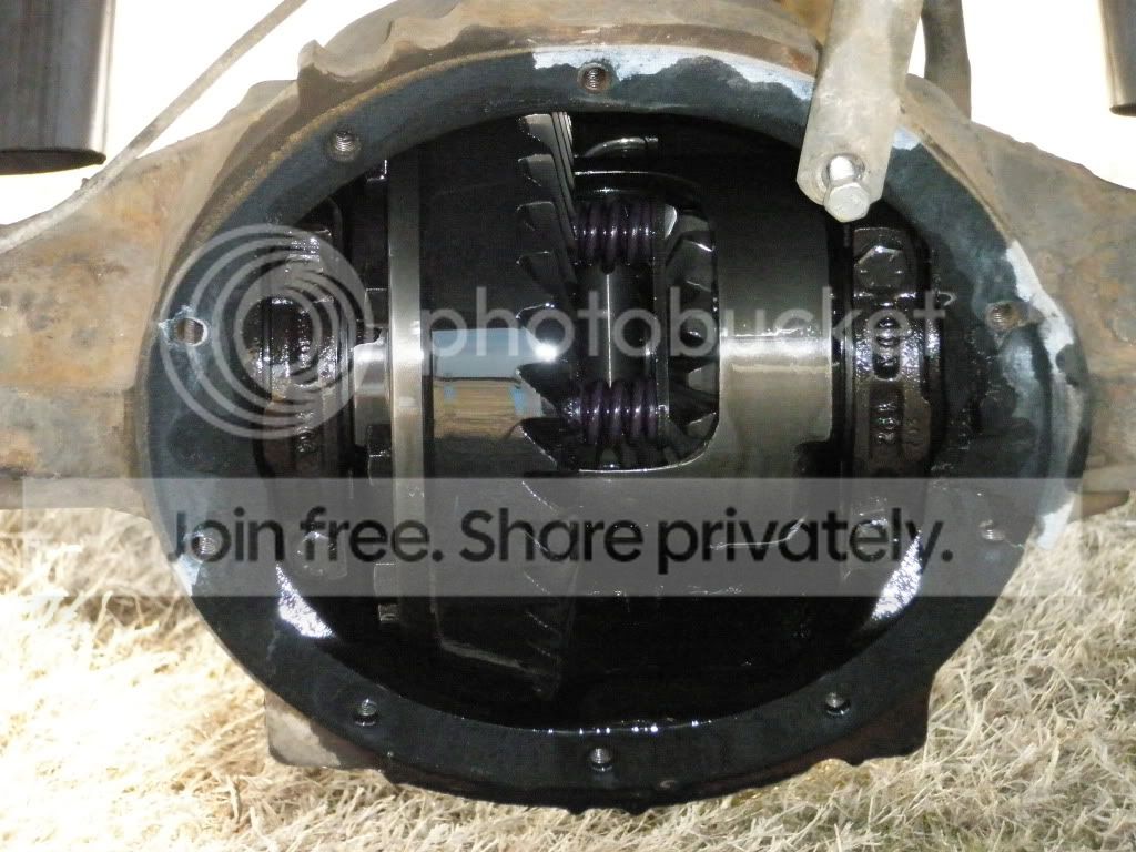

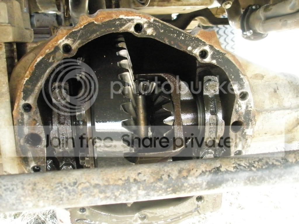

The bolts around the differential are 1/2". Starting with the bottom screws go around the cover till the oil starts to run out. I would take all of them out but the top one, leave it for last. Then go ahead and take the cover off. This is what you should see inside.
Rear
Front

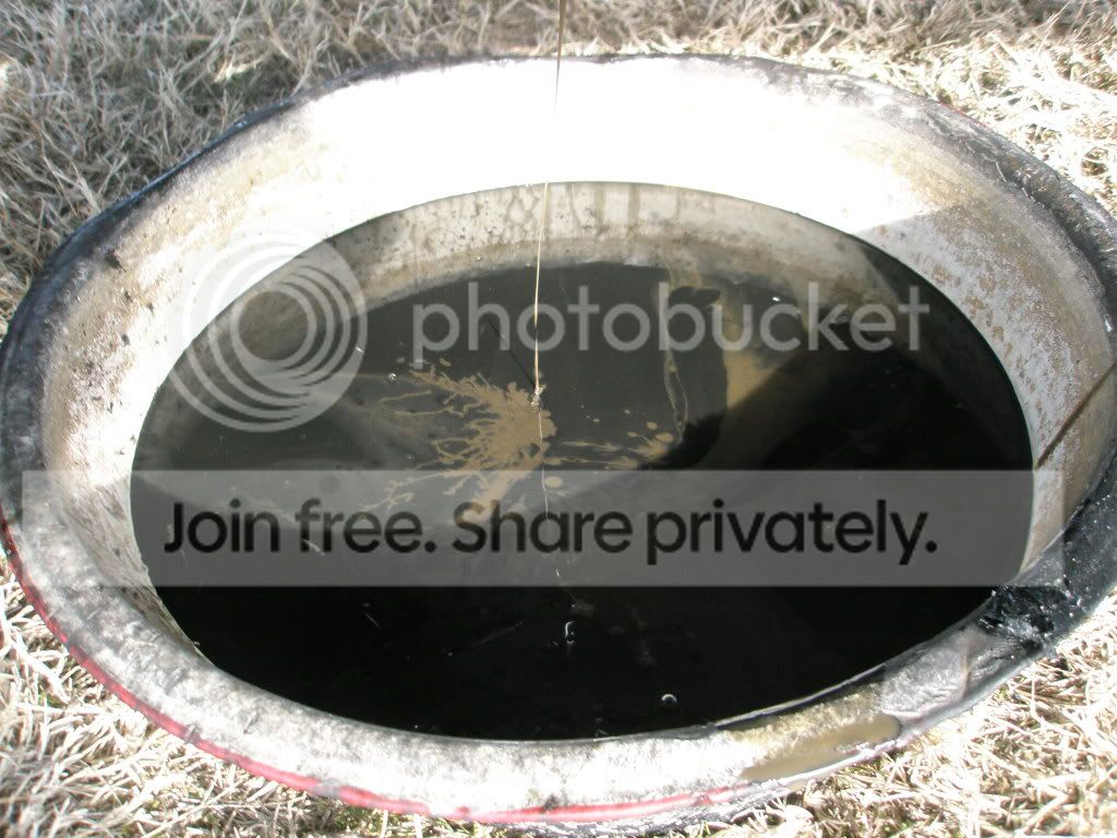

Let it drain for a bit and take a rag and clean the cover along with the what you can of the insides. Make sure you clean around the seal really well. I took a wire brush to it. Check for any metal shavings or for worn out gears. Here is what the fluid will look like. Mine had some water in the front end so it's a little more milky.
