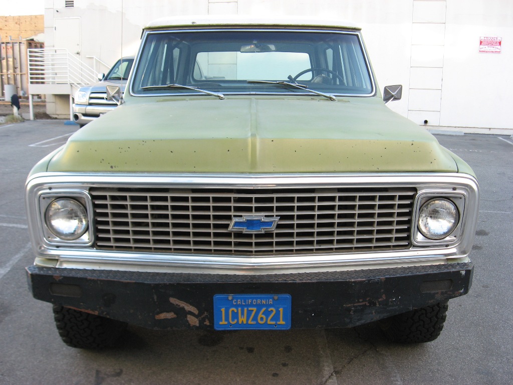

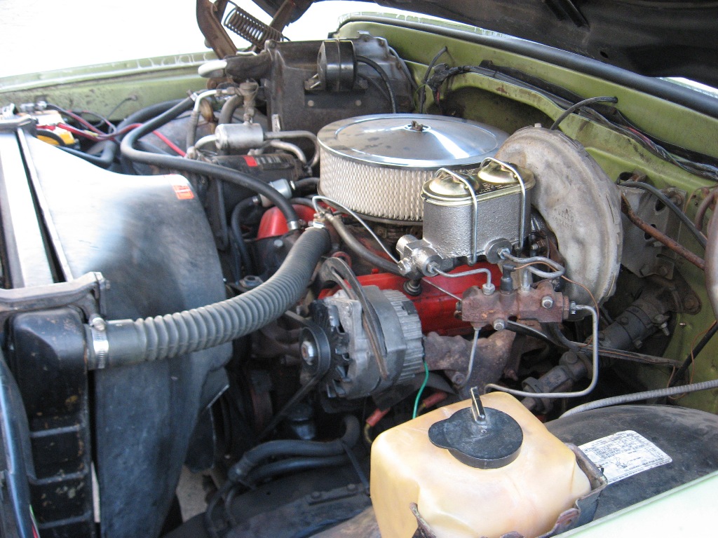

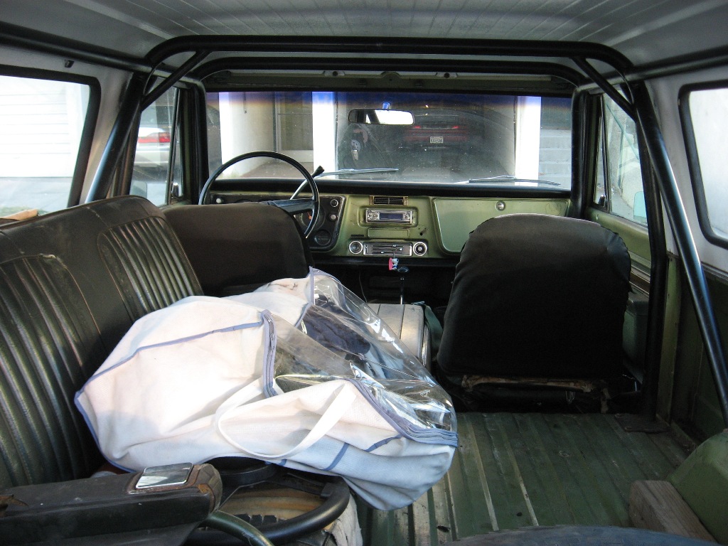

Oh, and here are some pics of my Blazer as it sits today:

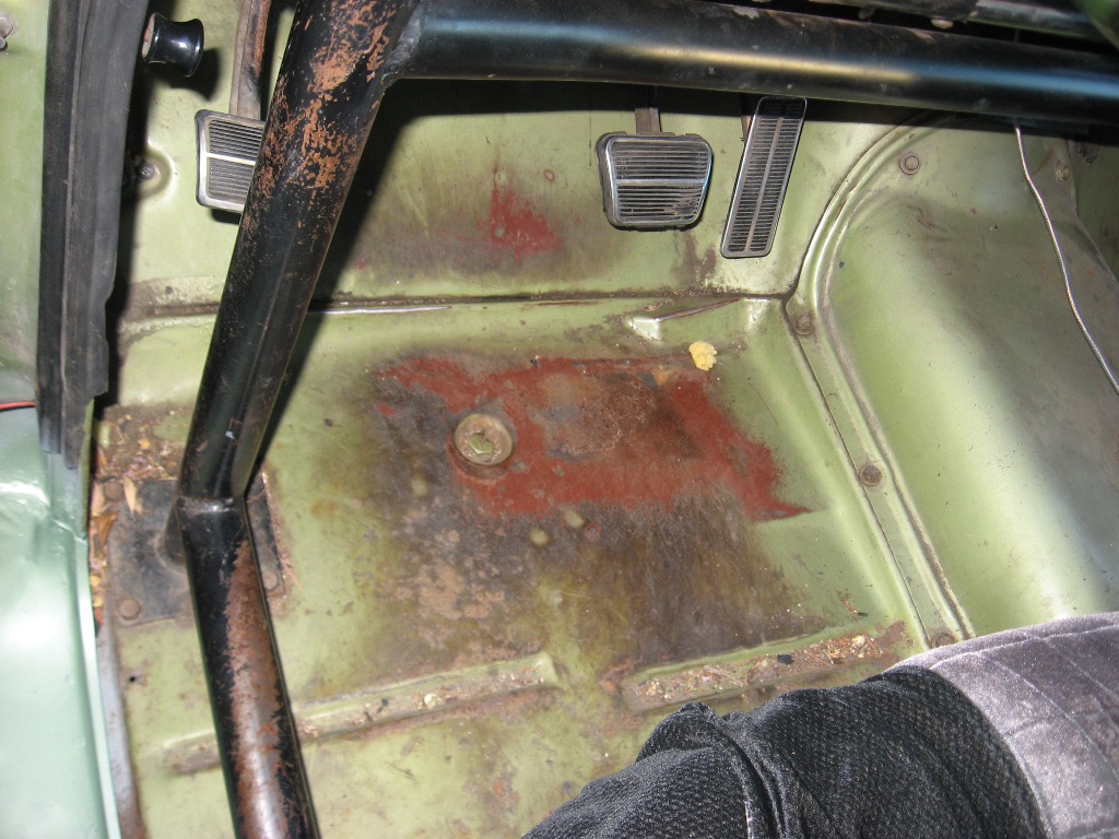

No rust in the floors! :)
Mostly stock under here:
And a few with the 33x10.5 Swampers that are to large to run with the stock list. The right rear hits the front of the fender on larger street bumps.
