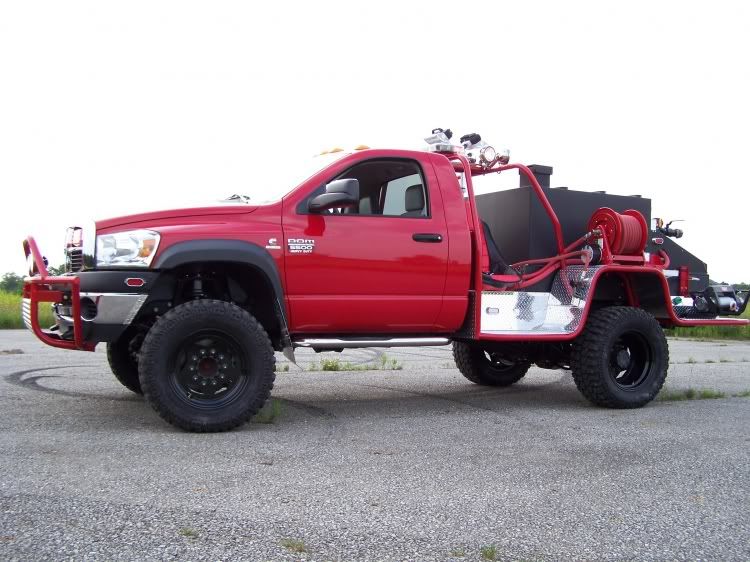

My ford is F450 single wheeled with 20x11 rims. The 450/550 & 4500/5500 share bolt patterns. 10 on 225mm I'm fairly sure. There's many more heavy ply large diameter options for 20" than 19.5".
I got the rims from 1st attack engineering. In the states there somewhere. They build these bush firetrucks you're talking about. I just bought a set of the rims they use on their own equipment.

And Demon that truck looks awesome

Demon that truck looks sick. :saweet:

The rims in my picture and on my truck are 20" industrial shells. There's almost an endless selection of tires for that size. And military tires. Don't get pigeon holed into 19.5" crap.

The 37" toyos on 20" rims is what I have on my truck exactly. The rims from 1st attack are 20x11 industrial shells. Way more steel than any 5500 could ever hurt.

And just because I'm a pic whore below is the truck in question and a pic of the engine just because it's bad ass.
