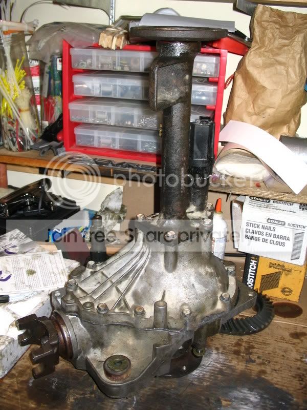

OKay as far as the actuator goes, I have some pictures to help. The actuator is on the front side of the axle tube (long side/passenger). This first picture is just of the passenger side tube when its disconnected from the differential case. The actual actuator isnt threaded in but you can see where it goes there on the front.

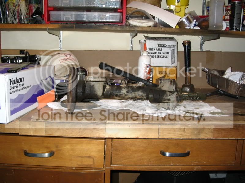

Here you can actually see the little plastic actuator.

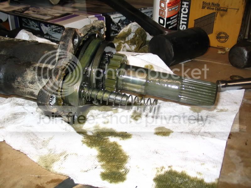

Now this next picture just shows how it all works. The actuator pushes the shift fork over to lock the two piece shaft into one.
