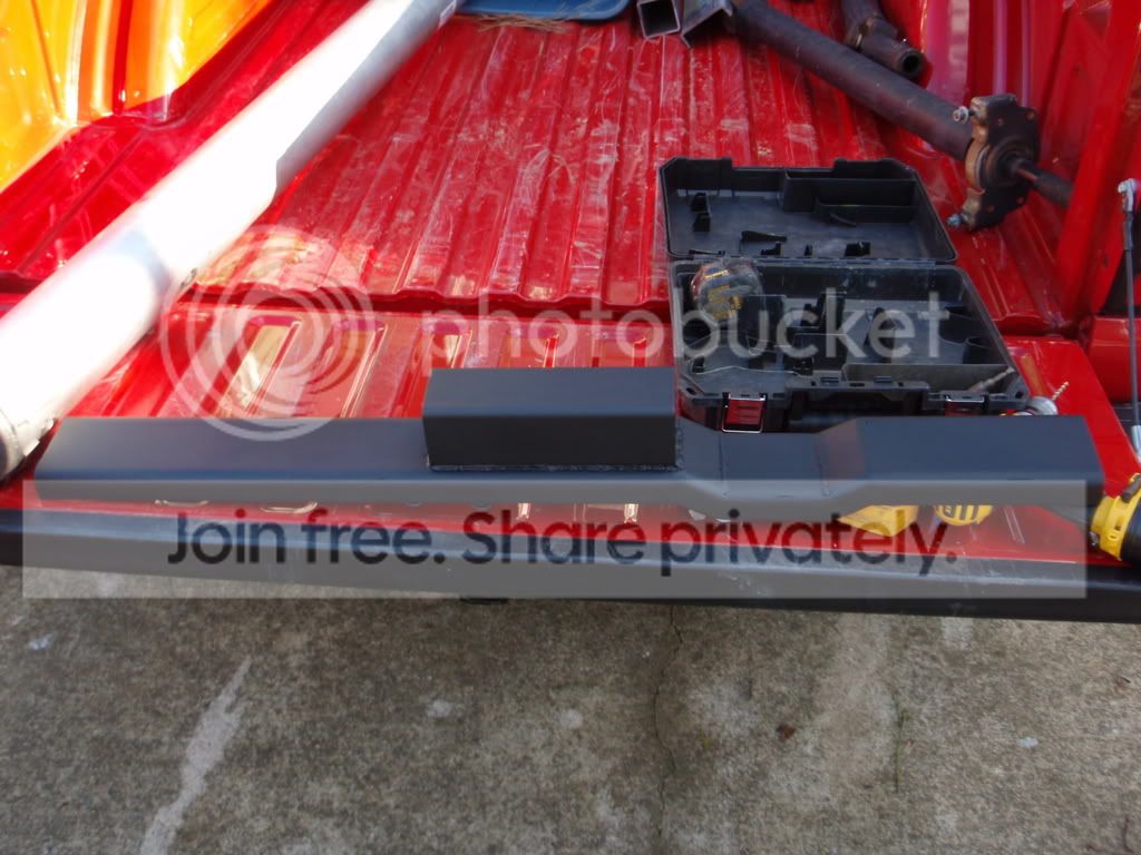

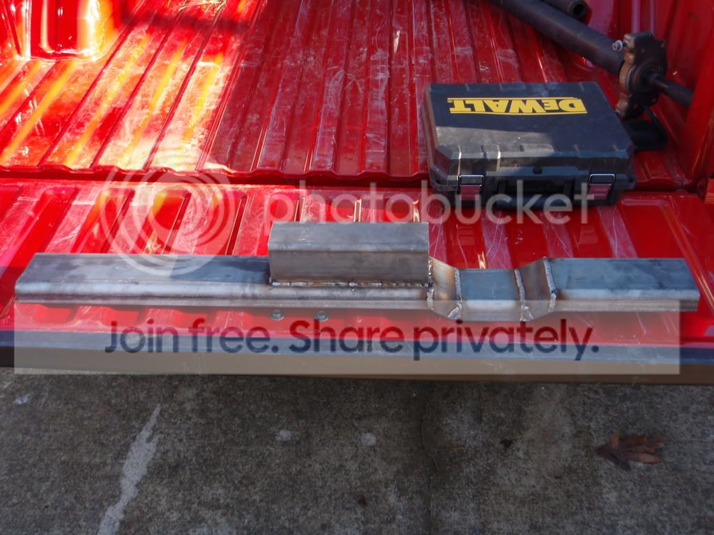

Well i guess i might qualify, but i dont think im as bad as some. The most recent thing i made was a cross member for a mid-shaft bearing for the DD. When you don't have a rig you have to work on something, glad I finally picked up another. Anyways, here is a before and after shot of the same piece. I could be really anal and mention the pits that could have been filled in. A few extra minutes spent is well worth it though when you know you will have to look at it again. I am my own worse critic. Not the smoothest beads, but i know they're strong.
