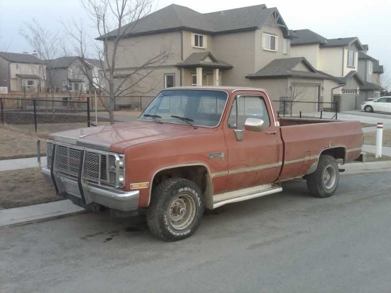

I love my lifted pickup, but I do a lot of city driving now and gas is killing me. Looking at this little grandpa rig as a more affordable option that will still fit all my carpentry tools. What do you guys think? What should I look for (besides the normal) sense I've never had a diesel.
Anyone what to buy a nice lifted 3/4 ton :deal:
Doesn't look too shabby for 1500 bucks...
Diesels are kind of quirky,you'll have a lot of "new" things to learn about them and what troubles they usually have compared to a gas engine...many parts like the injector pump and injectors are quite costly,prone to failure if filters aren't changed often,and "simple" repairs like changing a valve cover gasket are much more time consuming and difficult,as the intake manifold & injector lines must come off first!..a far cry from the 4 bolts on older gas V8's!...diesels will save you some at the pump,and dont need a "tune up" as there is no plugs,distributor or wires,carb,etc--but you'll be pouring it back into the engine eventually..
You'll only gain about 5-8 mpg more than a good running gas engine with a 6.2,and you say you do a lot of city driving--that is where a diesel delivers better mileage,but they also like to be RUN for long distances,starting a diesel up and shutting it off often for short trips does not do them any good,and you'll be replacing the glow plugs often (80 bucks per set of 8!)...and starters can wear out fairly quick if you need to crank them for long and often too...
I like my two diesels OK,but I'll admit I am tired of having trouble getting them to start every time it dips below freezing--well,my Suburban anyway,my '82 pickup does start OK ,but sounds like a bucket of rocks in a stonecrusher for a good 5 minutes after it starts...I'd probably have been better off if they had a gas V8 like a 305,for the way I use them--I go only 10 miles a day,and my trucks sit a lot,not the best thing for a diesel to endure..
That's a project, not a daily driver IMO. And if mileage is killing you, you should pick up a used Honda Civic, Toyota Corolla, or Geo Prism for the same price and get 30+ MPG. You're lying to yourself if you think this truck is going to help with your gasoline bills. If anything, you've just dropped $1500 which could buy about 550 gallons of gas for your current truck, then you have to add more insurance (what, additional $20 - $75/mo?) and parts to maintain it (oil, brakes, coolant, tune-up, etc.) and fix what may break, maybe another $500 to $1000?
Face it, what you are really doing is spending $1500 for another toy. :D

To me that truck looks like a possible grandpa truck with the running boards and all. might have had an easy live...

not for a DD and not for 1500....... I bought this one for 500.
I average 15 mpg in town, and 22-25 mpg on the highway with my 6.2 pick-up.
It's not fast, but I always get where I'm going.
Check for oil and fuel leaks, see how it starts when dead cold, then take it for a drive.
Glow plugs i get 2-4 years out of. No worse cost than spark plugs IME. Filters take a beating if the rig sits often, or you get fuel from some podunk station. Stick with the high volume places and drive the rig regular and filter changes can go a year or more. I'd consider it, but not for $1500. I'd go maybe a grand on that truck...
