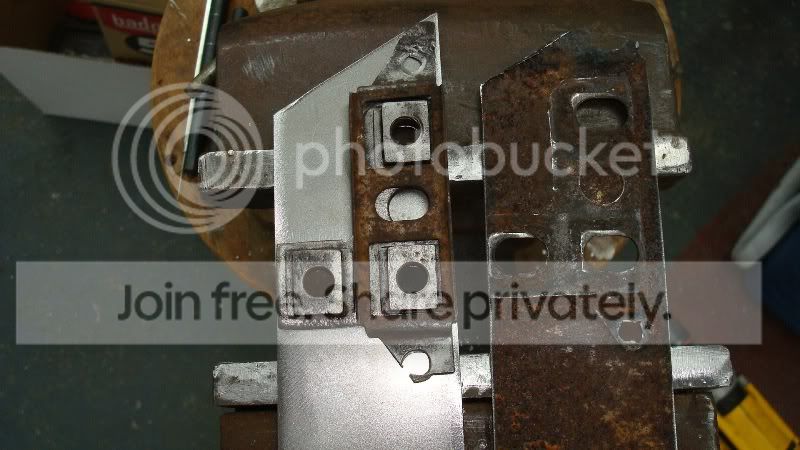

In case you haven't already solved this, here is what is behind those a-pillars
Basically it's an L-shaped plate that's been drilled and tapped with the threads for the hinge bolts. You could cut access panel from the inside to remove it. Then weld it up and re-tap the holes, or just build a fresh plate to install inside that plate cage.
Definitely a lot of effort required to fix a stripped thread. Simplest might be a helicoil repair since you can do that from the outside.
