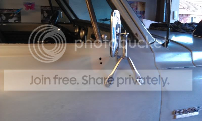

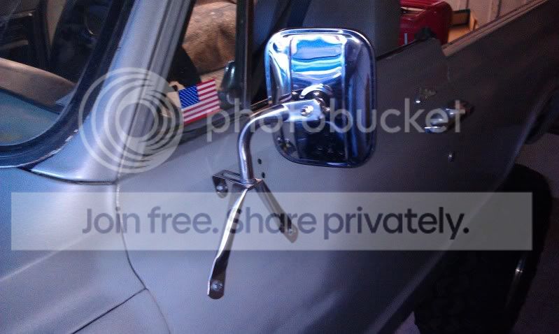

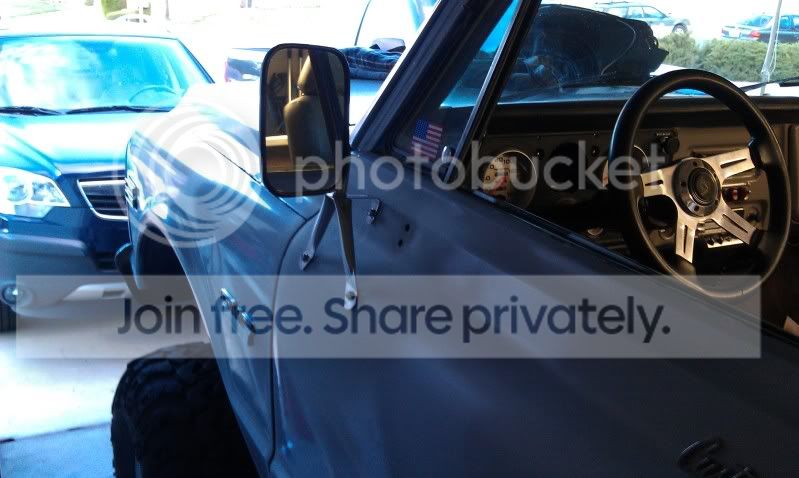

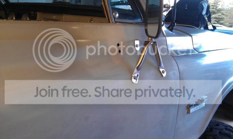

I don't think you guys need door pics anymore, but here are my mirrors and remaining holes from the smaller more attractive/useless mirrors.
What are the measurements on those, and can you see pretty well out of them? Those look nice, but I would still like a smaller base... I'm just a picky B****:whistle:
If these didn't wobble I'd be happy as a clam at high tide. But that's not the case with 37" bias ply tires.
ahh, prolly not gonna cut it then... since I'm running 39" TSL's. The search continues!!!
