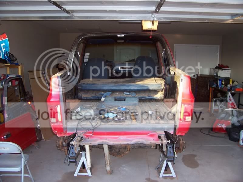

How much do u guys cut of the front and rear to narrow them????? me and Boggerless are wanting to know, we might do his ride.
I think I took a total of 20+" out. For some reason I'm thinking I did like 11 or 12" per side.
http://i13.photobucket.com/albums/a276/mjdannenberg/SUC50058.jpg?t=1170298592
I took 8 3/4" on each side in the front. I took it from in between the rad support and headlight bucket and welded the headlight bucket back real close to the rad.
and in the rear I moved it in all the way to the frame, i think it was 16" on each side.

:haha: :haha: :haha: like i said, my rear will be easy.a couple notches and cut back the bumper.
I have yet to look at the tail pan in my jimmy but I'm hoping that there is atleast some sheet metal there.
Boggerless you are still a pic hore, I could do that to my bed, but no way in hell will I, But we can do itto your truck.:D ;)
