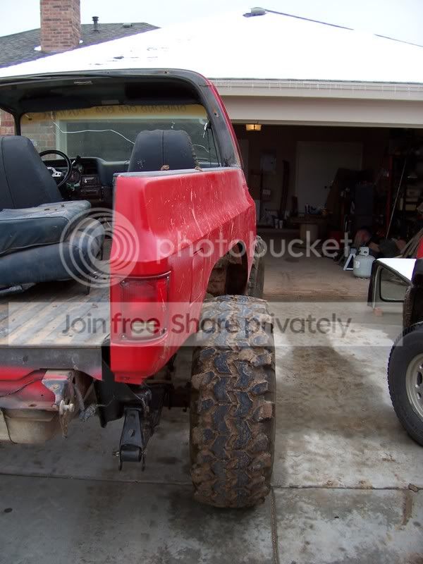

I tapered my truck bed all the way to the frame. Don't know exactly how many inches. This pic is with the skins just hanging on and obviously in an unfinnished state.

thats sick bro.can you weld like that Mike???:D
did you leave the fenders straight and just move the back part of them?

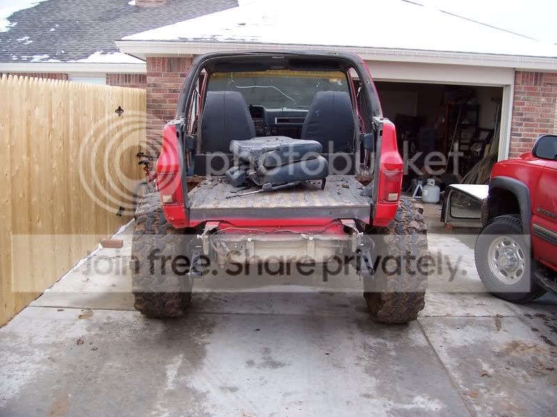

Here is a little update. It is complete for the most part. Enjoy.
Just need to brace up the bed sides in the back. I get to test out the new suspension this weekend. :saweet:

I built a whole new bed out of tube and just have the quarter panels hanging on as skins. I used 3/4" expanded metal for the sides to hold stuff in yet be light. For the floor it is 1/16" treadplate that is bolted down to match the contour of the frame. I just mounted the cell to the new floor but cut a hole the floor to sink the sump of the cell down a few inches.

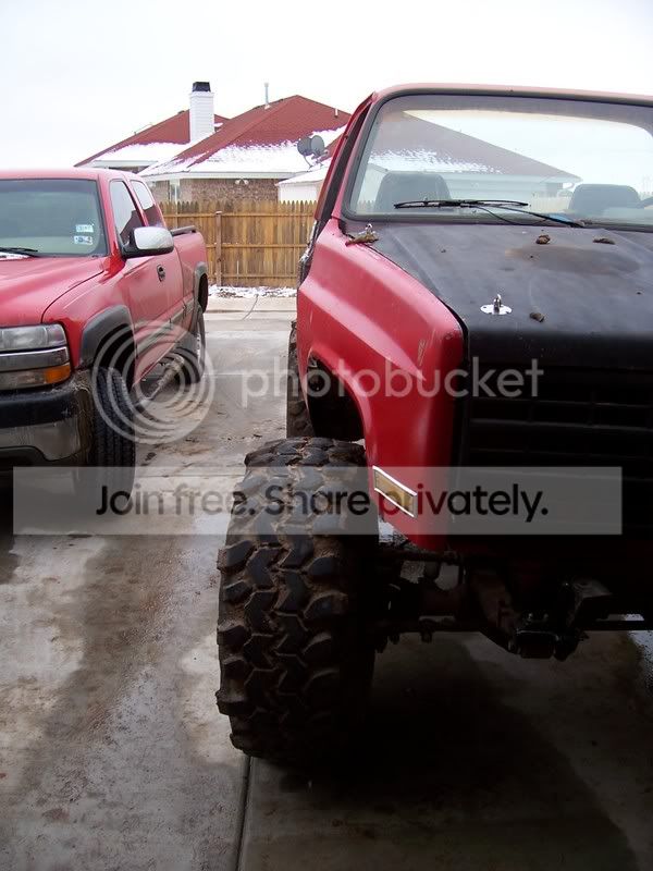

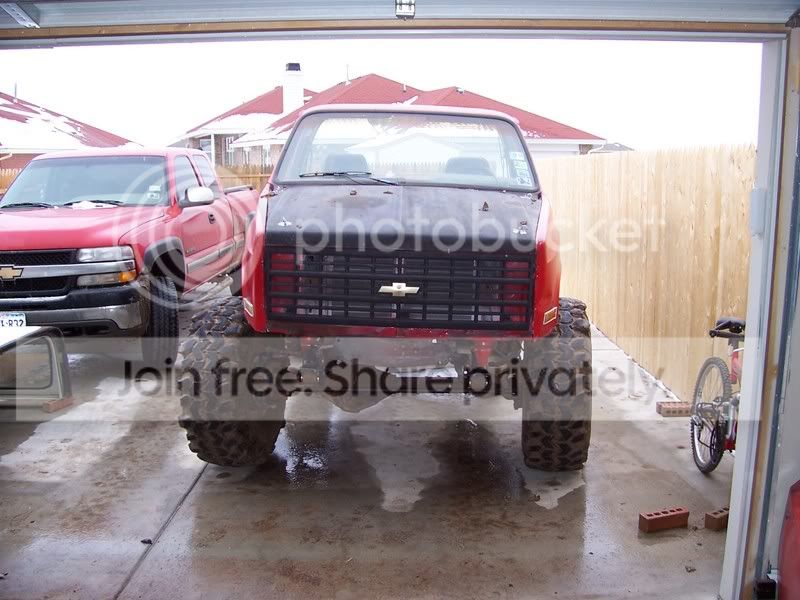

Boogerless how did you taper the front fenders? did you just cut them and weld them back together? I have been thinking of doing the front too but I would probabaly tube and skin it.
I think I ended up removing 22" from the front and something like 24" from the rear. No floor in the rear to worry about so that part was easy. I kinda rolled the fenders around rather than a sharp angle. The front was done as a one piece tilt front end. No hood hinges to worry about this way.
what kinda problems where there for stock gas tanks and body mounts? what all had to be done to make the beaver tail work and look descent?
what all had to be done to make the beaver tail work and look descet?
