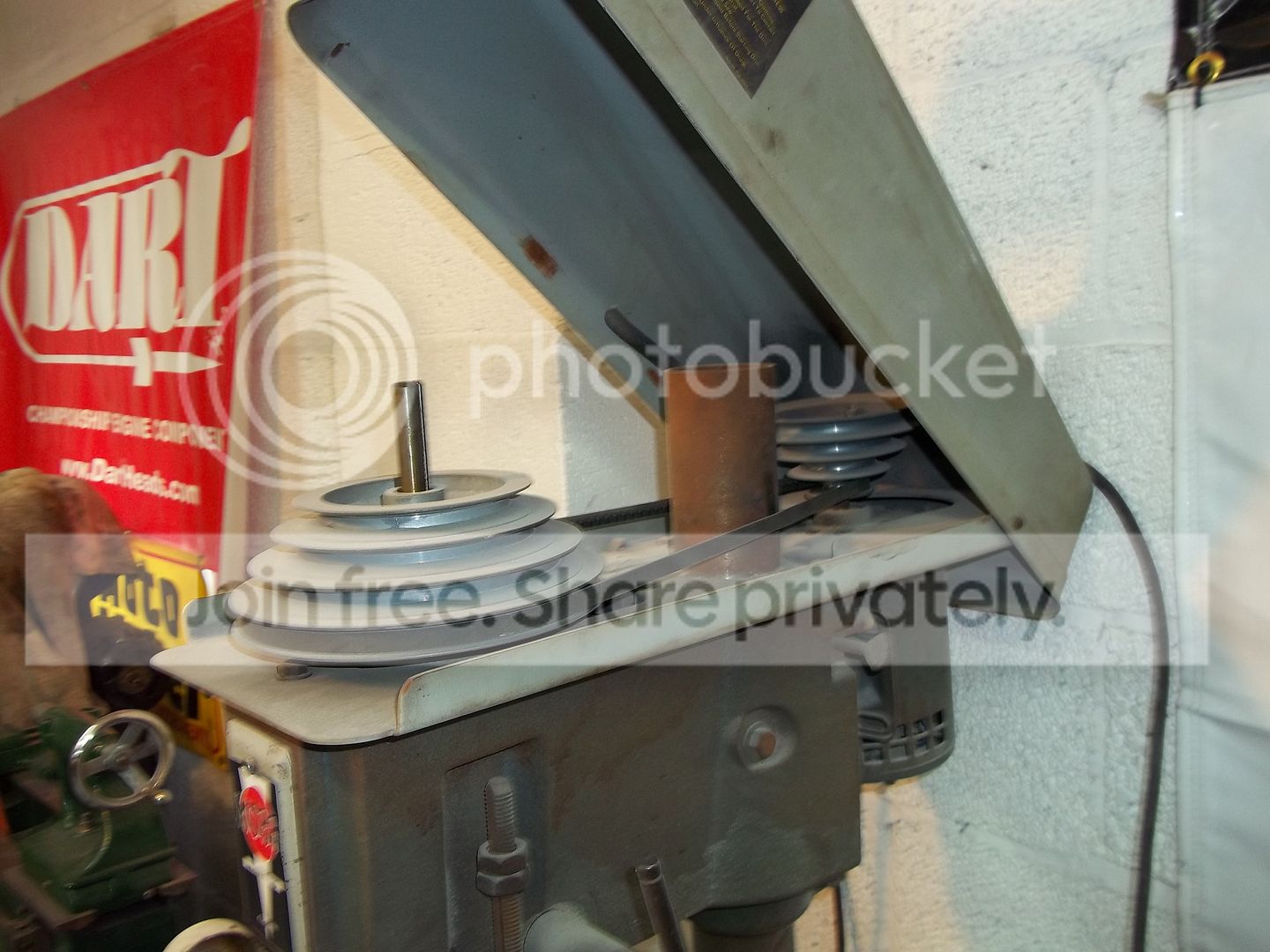

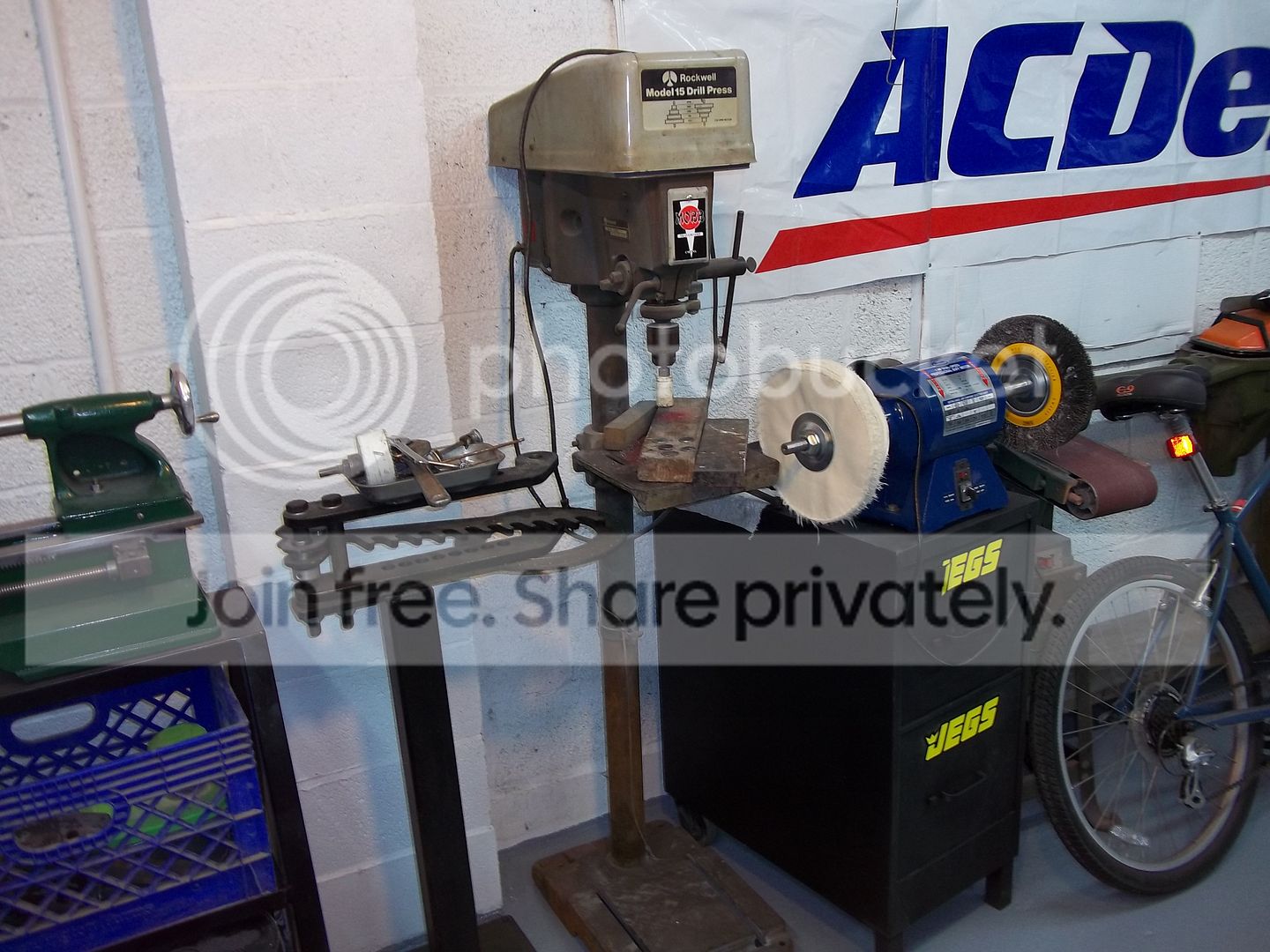

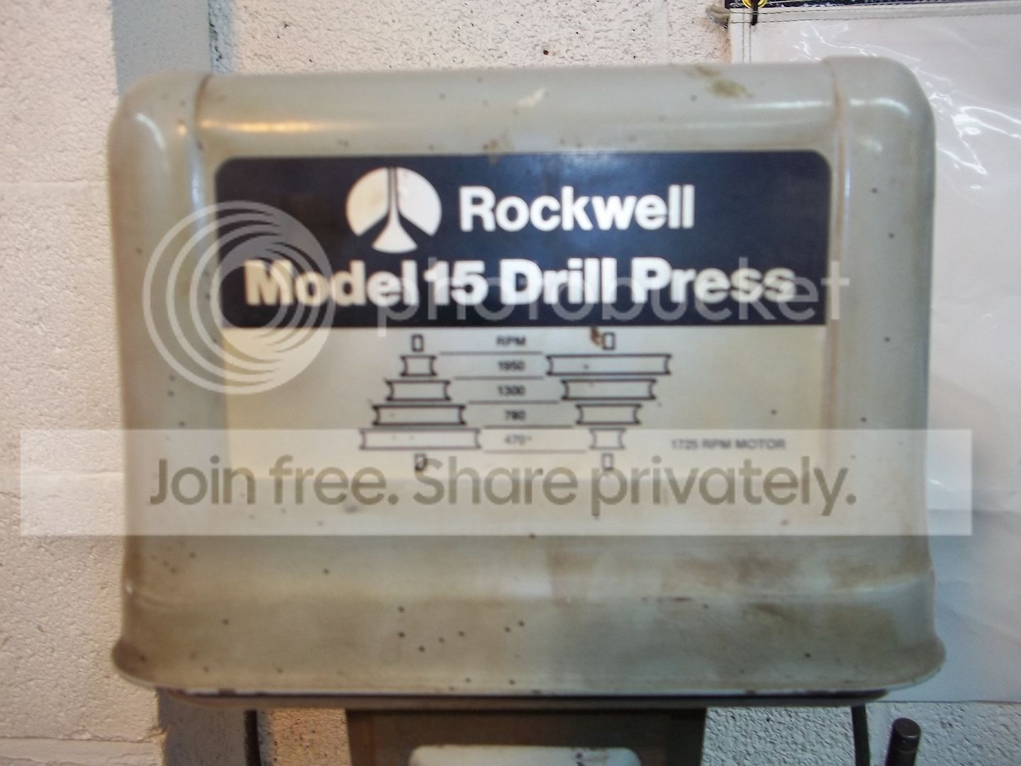

I run an older Rockwell.. with the belt up top and 4 spd's..
heavy = good :D
