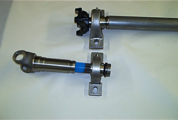

If I understand you correctly you have what's called a slip style midship- and it should be possible- here's a pic just to make sure were on the same page- the bottom one is a slip style carrier or midship- Good luck- Jess
