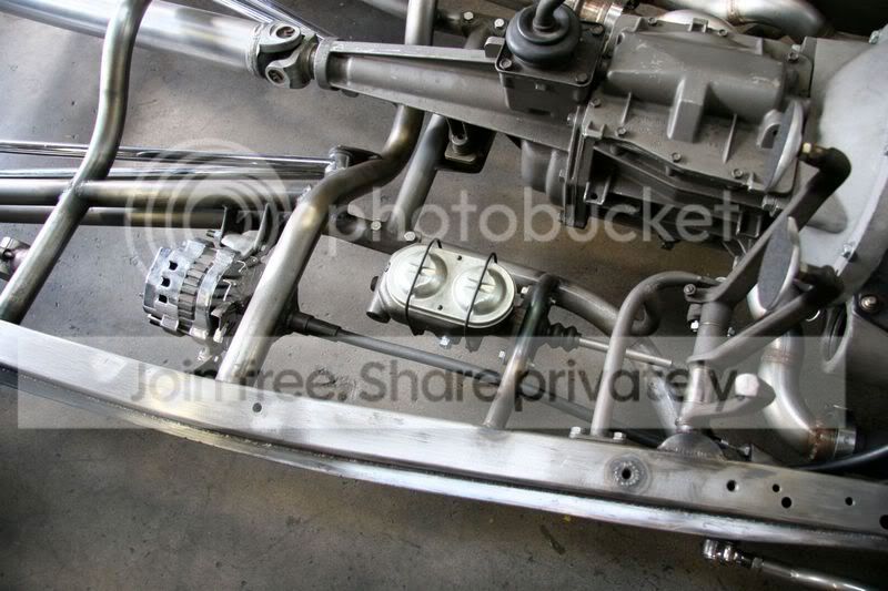

appears to be some sort of flex drive like a dremel tool would have but larger/beefier.
