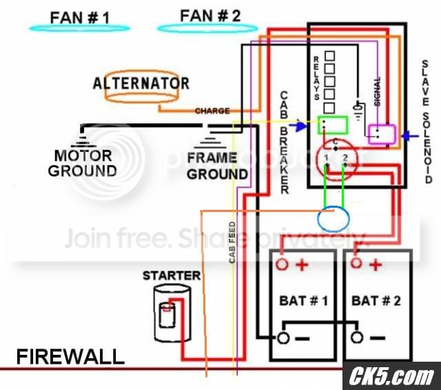

pic of mine
Kgblazerfive,
Referencing your drawing, did you have to run a separate wire to your alternator to provide power to it to wake it up? If so, could that come from my ignition that is already energizing my solenoid?
Also, you have two solenoids in your drawing. Could I run my primary batter to the hot side (starter side) of my single solenoid and run my second battery to the other side and therefor not need two solenoids?
thanks for your help
William
you can take your excite lead right from the main charge post on the alt... just piggyback it...
here's my 1/2 done diagram of mine.. the red circle is my marine switch. the blue circle below it is the ACR, the orange wire coming off it is the parallel trigger running into the cab to a parallel switch......
you can use either bank as a primary with the marine switch, both charge all the time as needed due to the ACR.. they can be paralleled with either the parallel switch from the ACR or by putting the marine switch to all...
the slave solenoid is what many refer to as the "remote Ford solenoid mod"

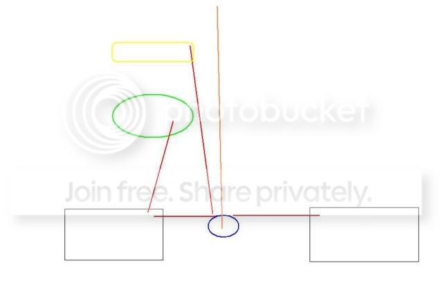

ACR - alternator
Where does the alternator connect? I don't know that i want to put in a marine switch.
In the earlier diagram i did, i assume i would replace the isolator with the ACR and put in a parallel switch but I'm not sure where to connect the alternator.
Thanks again for the help.
Once i finish this I'll create a final (better) diagram for posterity...
William
my alternator charges at the "in" side of the slave solenoid, basically the "common" output of the marine switch... it's the orange "charge" wire on my diagram...
with an ACR, in your case, you would just run a charge wire to the primary battery, or to either side of the ACR..
tho with an ACR, your diagram would be MUCH simpler, you wouldn't have that solenoid over on the side, the ACR would be your solenoid..
ok, here's a quickie diagram of roughly how simple that could be.. the blue is the acr. the orange wire off it is the parallel trigger.. the green is the alt, it can charge either to the battery, or that coresponding post of the acr... the yellow is your starter, it can be fed from that side of the acr, or that primary battery...
new dual diagram
That sounds great. I can take the solenoid back since i won't need it.
That's a very clean simple design that i was looking for. I'll get this set up and then post a new thread with a condensed version of this discussion for anyone in the future that want to create a very simply dual battery solution.
