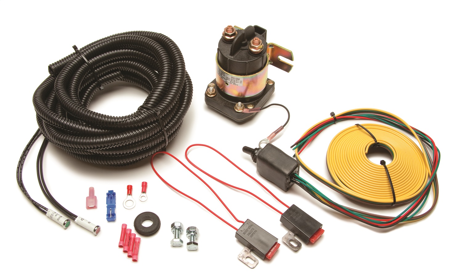

Ive got a 88 K-5 Blazer Ive got the tray and all I need to find is a good wiring setup/Isolator. any one know of any
Painless Wiring makes a nice setup that allows you to control the second battery..isolate or combine. Its about $80, they also have it in a waterproof version for like $150.
I plan on gettin the regular kit sometime soon.

Just wire your batteries in parallel.
perko makes a very simple switch to wire. for marine set ups but i have one and I love it. cheap to!
Isolators produce voltage drop, go with the Painless setup, it uses a constant duty solenoid. Hell, if you can find a good solenoid, you can wire your own setup. Besides, if you run a perko marine switch you'll be running all of the current in the vehicle into the passenger compartment.
