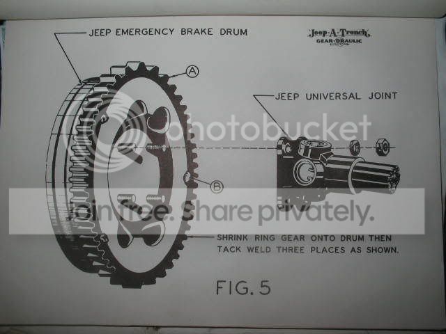

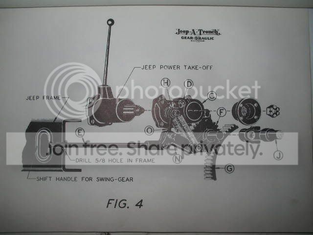

The google says it's a CJ2A/3A trenching setup
"Quick lesson, the Jeep T-case is placed in neutral during trenching with either of the trenchers. There is a drive shaft from the trencher that connects to the drum brake via a added ring gear and "Swing" gear to propel the Jeep forward, referred to as "travel." :the transfer case is being driven, just by an alternate source."
