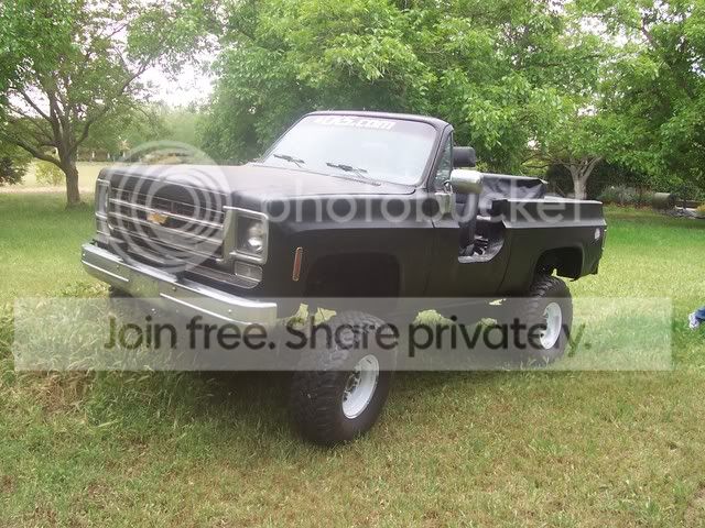

I have a friend that ran regular wheels on a dually D60, where my tires only have the outer row of tread sticking out, the dually axle made 3/4 of the tire stick out from under the body. I have a pic somewhere but I have to find it.
That's about the look and width I'm looking for.

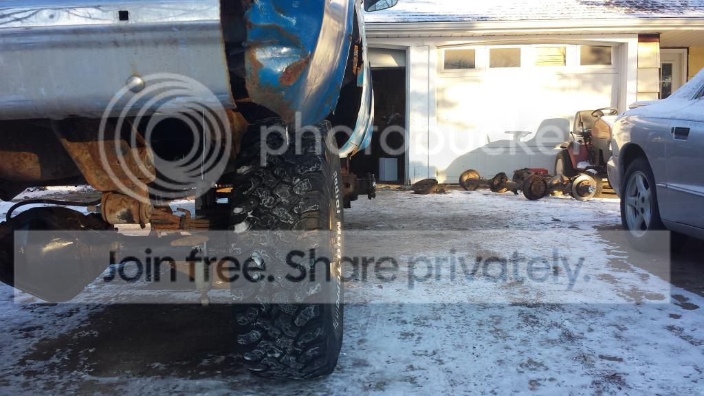

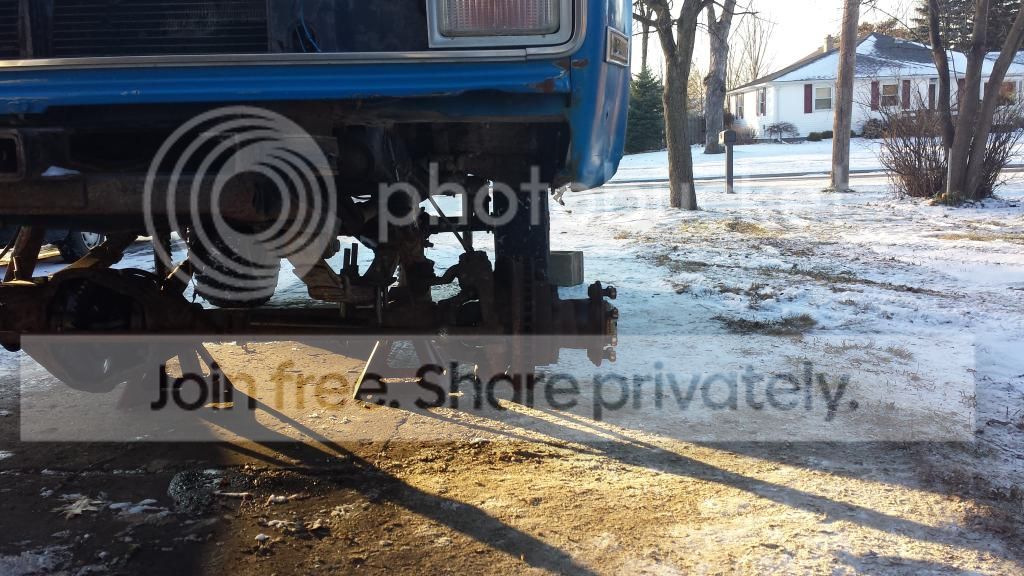

My cousin ran with dually hubs on the front of his 60 for a while until he could find a set or SRW hubs. It was way wide. I don't think I have any pics with the front tires on, but this give you an idea of the WMS differences, The rear axle is out of a cab/chassis truck I believe....it has a narrower WMS measurement than the normal truck axles do.
Note, there is a tire on the rear axle in the first picture, it's just in the shade.
awesome thank you. this was exactly what I was looking for. that front looks like it would be the perfect width. but yeah steering would be weird.
